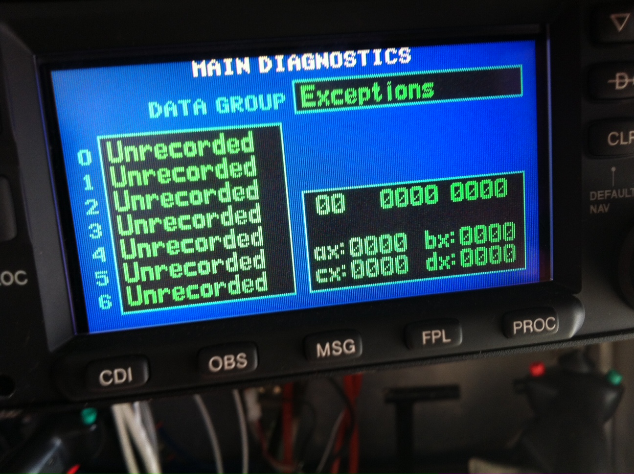

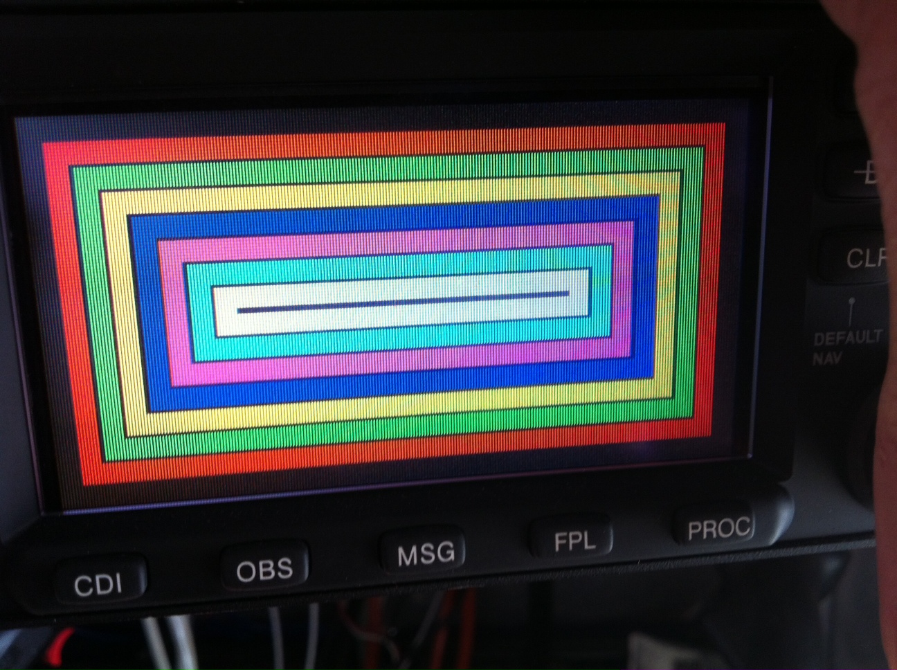

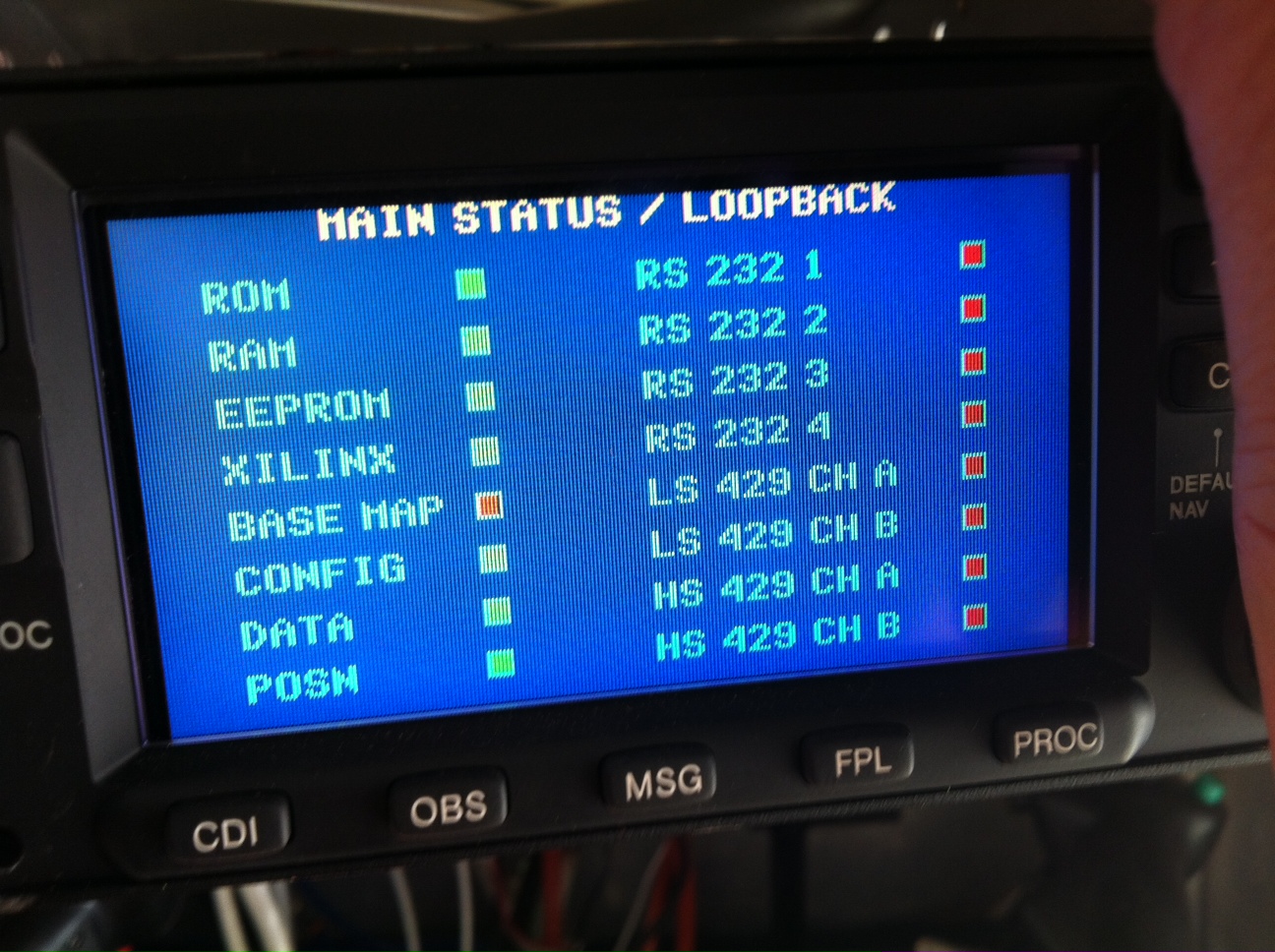

Today I resoldered one of the wires on my GNS430 connector (it was the RS232 Out 1 wire which had mistakenly been connected to the wrong pin, which is why my GNS was not communicating with my Trio ProPilot) and when I put everything back and powered up the GNS430, I got a strange startup screen with lots of concentric colored boxes. The unit appears to startup in SETUP mode because when I turn the right dial I get the other setup screens. But no matter how many times I try it will not startup normally.
I have posted some pics to give you an idea of what I see. The screen that intrigues me is the Main Diagnostics screen which appears to have "Unrecorded exceptions", whatever that means.
Does anyone know what this behavior indicates? Is it broken in some way? Can someone who has a GNS430 start it up in setup mode (press the ENT button while turning it on) and tell me if their Main Exceptions screen looks like mine?

Garmin support says that the unit is booting in Test mode and suggested to
double check whether pin 75 of the 4001 connector is grounded... (I hope it
is, otherwise i might be in for some repair co$ts)...

Turns out that removing the data card, rebooting the unit and then
re-inserting it did the trick; just as Garmin support suggested! Phew...
