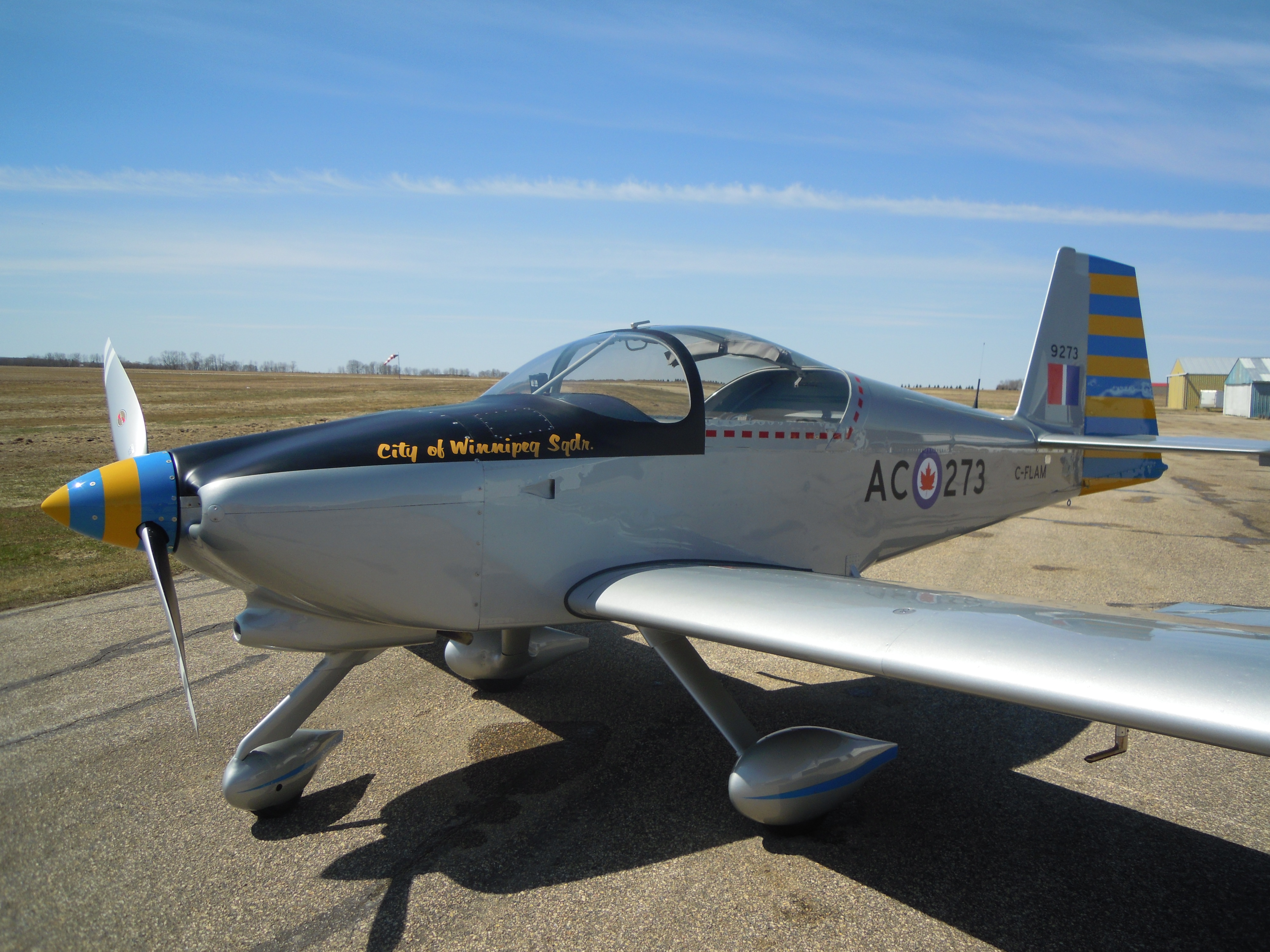

Hi Matt,
Yes, I used the Aircraft Spruce Windshield Fairing on my RV7A. I was very happy with the final result. The only thing I had to do to get it to fit well was cut it at the top center and remove a small piece. Yes, I would use it again and I would recommend it.
We just returned from a 4000nm trip in the 7A and everything worked well. Attached is a picture of the fairing in place.
