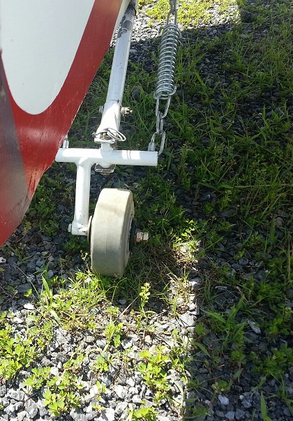

PostPosted: Wed Jul 23, 2014 9:32 am    Post subject: Re: Alternative Tail Wheel Steering System Reply with quote
Would love to see a few pics of the tail wheelcompression springs

PostPosted: Wed Jul 23, 2014 12:36 pm    Post subject: Alternative Tail Wheel Steering System Reply with quote
Hi Barry,
Here's a shot of the compression springs (other side is the same, of
course) on the FlagFly. Also shows a wider tail wheel to replace pizza
cutter.
Dave Kulp
Bethlehem, PA
11DMK
