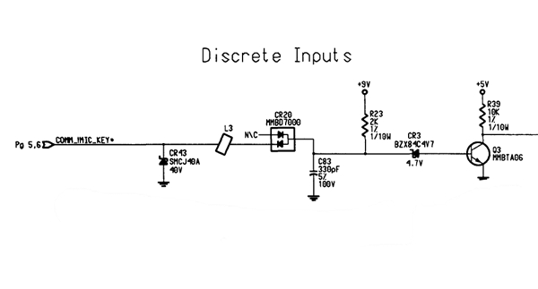

I've been troubleshooting my intercom system and radio operation and eventually found one of the mic jacks had tangs that were bent and touching. After unbending the tangs, the intercom system worked, but the radio seems to be stuck on transmit. I pulled the radio out of the plane, isolated from all associated devices, powered it up and the "T" light is constantly on.
So, it's a radio problem. The radio is actually putting out a weak signal, but no voice. However, if I activate the PTT switch, it will transmit clearly. Nevertheless, can't receive because the T stays on. Could the shorted mic input have caused this fault? Can anyone give some advise on how to remedy, besides going straight to the avionics shop?

Doesn't sound good. In the service manual, Figure 6-8
sheet 5 of 11 we find this excerpt of the PTT input
circuit . . .
[img]cid:.0[/img]
It seems likely that your difficulty lies in or somewhere close
to either side of this bit of circuitry.
