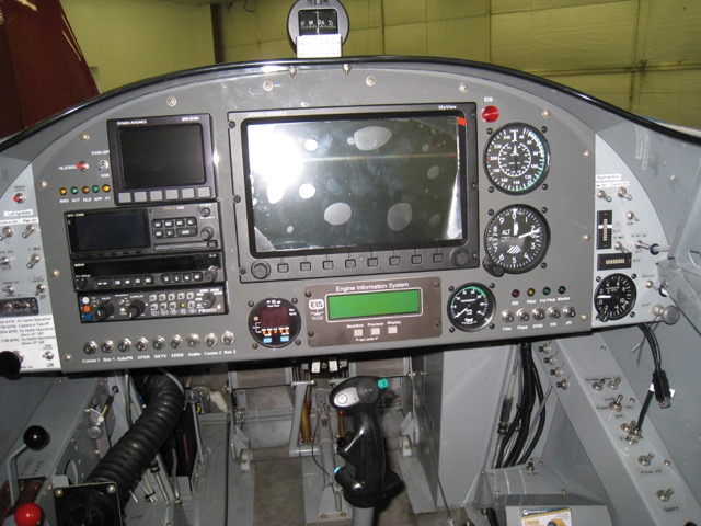

PostPosted: Tue May 05, 2015 8:10 pm    Post subject: Two radios or one? Reply with quote
Any chance you can upload pictures? I have a garmin stack and dynon d-100 d-120 and am thinking of upgrading to sky view for ads-b compliance and ads-b display.

PostPosted: Wed May 06, 2015 3:50 am    Post subject: Two radios or one? Reply with quote
Here is a picture of the RV-8A panel that was installed in Carl’s plane:
[img]cid:CE332F97-D054-4908-B99A-A64DD0BC3041[/img]
Radio Stack: Garmin GX 60; Garmin SL30, Audio panel
Major issue was depth of radios, but this was able to be worked out.
Tom Doran
