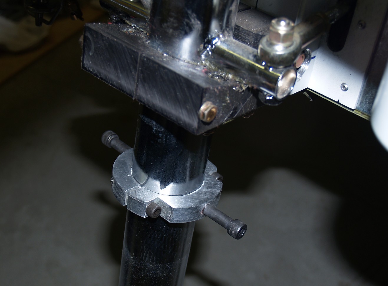

nfivesl(at)yahoo.com Guest
Posted: Mon Jul 17, 2006 10:11 am Post subject: Question about XL lower nose gear support bolts |
Hi Gig:
I looked through my backup photos and came up with
these two (attached). It's in a tight spot and engine
parts hide most of it these days.
Scott Laughlin
www.cooknwithgas.com
Working on canopy
