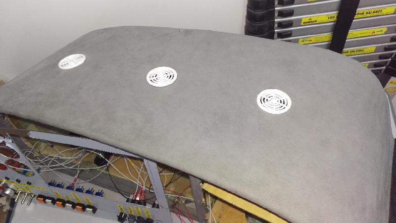

In my RV-10 I installed 2 (computer type) cooler fans in the dashboard, with the main purpose of cooling the atmosphere behind the instrument panel to keep all the panel electronics happy.
Those 2 fans get power through a thermostat, whose temperatures (to turn the fans on and off) can be set.
Further to this electronics cooling function, and copying other fellow builders idea, this fans may also be used to defrost the windshield interior surface.
But for this defrost function, I want to be able to turn On the fans independently of the thermostat, so I decided to put a switch for this.
Now comes the question: how do I wire this switch in relation with the thermostat circuit?
Do I have to use a diode?
Thanks in advance
Carlos

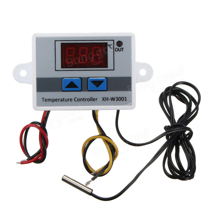

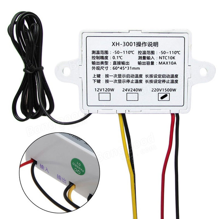

PostPosted: Sat Mar 10, 2018 12:48 am    Post subject: Defrost switch Reply with quote
René
I am using the 12V version of a very cheap Chinese thing called XH-W3001
[img]cid:A34F7607-A424-41EB-9649-64FFC6E6FBA0[/img]
I have tested it with my fingers temperature and it works very well.
The only problem is that I cannot find its schematic and neither you or I can read the characteristics
[img]cid:03B4ED9E-DE13-48B3-879D-F7FB742DFF60[/img]
but mr. Google will show you plenty of videos in English explaining how it works and how you set the temperatures
Cheers
Carlos

I am using the XH-W3001 that you can see in my previous post to René.
It has a small contactor (relay) which serves as the thermostat switch.
Again, if I parallel the manual defrost switch with the thermostat, my fear is what will happen when I turn on the manual switch when the thermostat contactor is closed.

argoldman(at)aol.com wrote:
So the question that is begged is what will blowing ambient air on a frosted windscreen do. In your car the defrosted air is heated additionally the air conditioner compressor is activated (temperature permitting) to reduce moisture. Your body is constantly creating moisture ( primarily through respiration and sweating) this condenses on the inside of your windscreen under certain conditions. Unheated blown air will have little effect. It will have less effect on ice on the outside. Perhaps a small electric heater will help.
Keep cool (warm)
Rich
Rich, I hate to disagree, but I have fitted three small computer fans in the top cowling of my Europa control panel. See attached photos. I have just completed the test flying of the aircraft, and these three fans kept the pilots side of the windscreen pretty clear, while my side (passenger/observer) was constantly misted up, and I was forever having to wipe the screen to clear it. This was in February weather in the UK (i.e. cold !), so I guess body heat was causing the condensation. Those familiar with the Europa will know that the control panel only stretches to three quarters the width of the cockpit, hence I wasn't able to position a fan for the passenger side, or I would have. As my panel is fully electronic, I guess the air being blown over the windscreen is partially heated by the output from the electronics.
Just as an aside, I changed the fan covers to brown (rather than white) having picked up a tip on here that using dark covers prevented/reduced reflections on the windscreen.
Just my tuppence worth Very Happy

As noted earlier, by another poster, you can google this device and get a manual and a youtube video.  It appears that the output is not just open relay contacts, but it supplies power, so don’t put a switch across it.  You could take the output to a 12V relay and then use the relay contacts, parallel with a toggle switch,  to turn on the fan, as I had suggested in a previous post.  There are other solutions, but this is a simple addition of a relay and a switch.

No dia 09/03/2018, às 23:54, Roger <rnjcurtis(at)charter.net <mailto:rnjcurtis(at)charter.net>> escreveu:
> A simple bimetal switch is all you need as a thermostat.  It consists of a bimetal strip which deforms as it is heated and closes the switch contacts.  I am not aware of any thermostat that would
> be harmed by paralleling it with a switch.  What thermostat are you using?

The manual that you can access on Google specifically warns against this.
See my previous email.

Dick Tasker, right you are. The manual warns against connecting power to the temperature controller output. At least I think it says that. It is hard to read Chinese. LOL Without having the controller circuit board in hand along with a schematic, an informed decision can not be made. Dick's suggestion about using a double pole double throw (DPDT) switch is the safe way to wire it.
Joe Gores
trigo(at)mail.telepac.pt
PostPosted: Mon Mar 12, 2018 2:31 am    Post subject: Defrost switch Reply with quote
Ok, due to not knowing what is the thermostat circuit, I will go the DPDT
way, like it was suggested by Dick Tasker.
Thanks Dick, don't we know each other from the Subbie group?
Cheers
Carlos
-----Mensagem original-----
De: owner-aeroelectric-list-server(at)matronics.com
[mailto:owner-aeroelectric-list-server(at)matronics.com] Em nome de user9253
Enviada: Sunday, March 11, 2018 3:06 AM
Para: aeroelectric-list(at)matronics.com
Assunto: Re: Defrost switch
way to wire it.
Joe Gores
