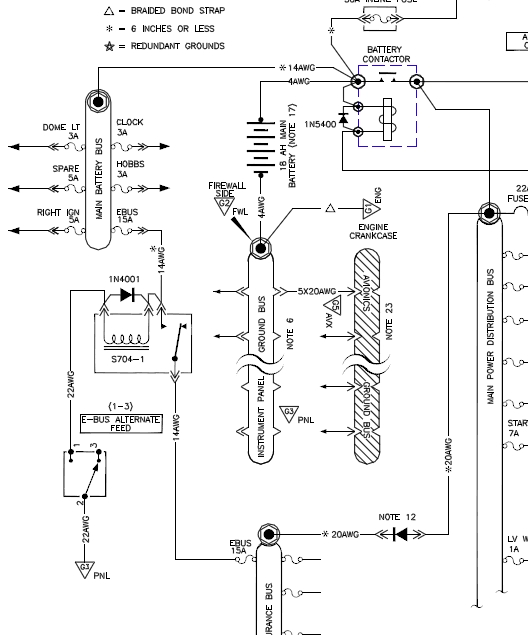

[img]cid:.0[/img]
If one does not require a battery bus
but with 'larger' e-bus loads, then the alternate
feed relay is still recommended. The relay
is mounted close to the battery contactor
hence a short jumper between the two devices.
That jumper is easily fabricated with an
in-line fuse holder. the in-line fuse is MANY
times faster than a fusible link.
As we've discussed quite a few times over the
years, fusible links behave more like current
limiters . . . very slow compared to fuses.
They are not recommended for in situations
other than those illustrated in the Z-figures.
