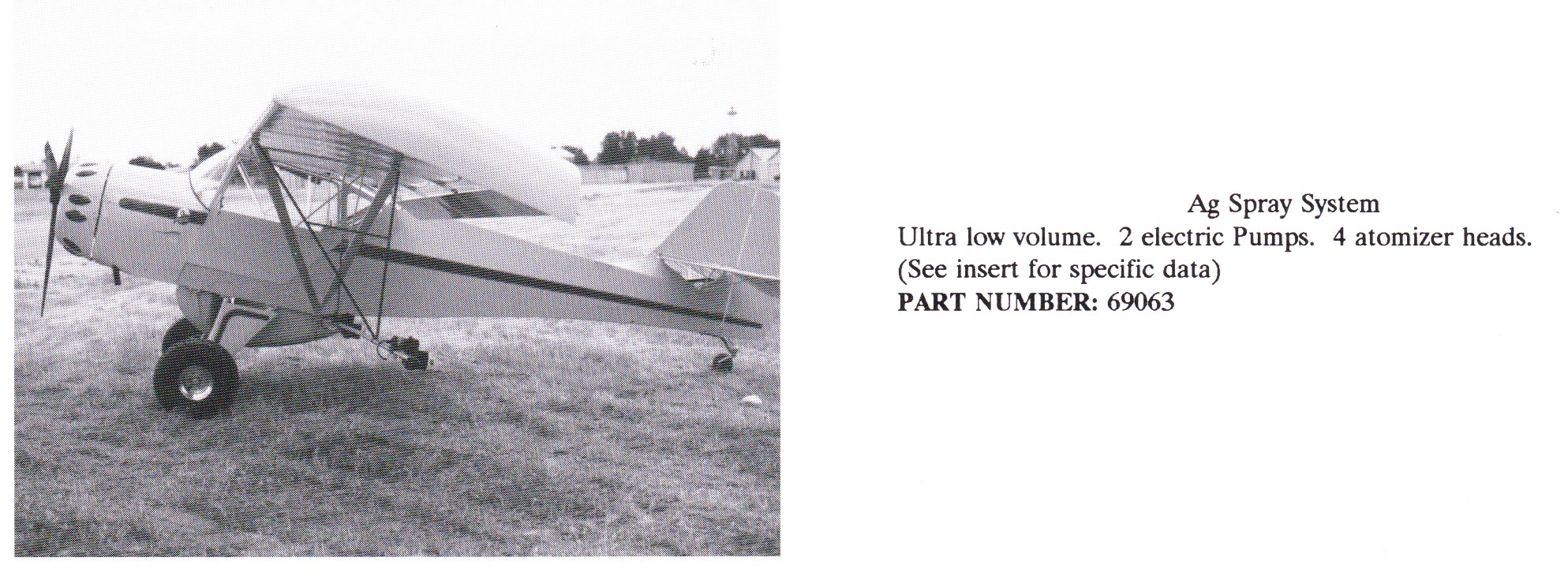

  I found a 1991 Denny Aerocraft Co. catalog listing for a Ag Spray
System  P/N: 69063.
It listed for $3,655.  There is a small side view photo which shows a
conformal tank mounted between the landing gear and spray system mounted
behind that. The system seems to be a horizontal tube with spray heads
across the bottom of the fuselage and additional struts attached to the
outer wing struts to support the outer ends of the spray tubes.
 The caption states: "Ultra Low Volume. 2electric pumps. 4 atomizer heads."
 I also remember seeing photos or video clip of it in action.  I'll
send that if I can find it.
 At least you know it's been done by a previous Kitfox Company. They
may still have the information in their archives.

Hi rex... i knew someone form our old school list would have seen
something. I wonder what they mean by ultra low volume??
With oshgosh goin on i'm sure many others like john mcbean will respond
later too but pics would be great if you find them.

Of course a ULV system design must have been chosen due to the
relatively lower load capacity available of a Kitfox. It would provide
the most effective coverage and thus be a viable choice for some small
farms.
 I scanned the catalog photo but the printed image is low resolution.
However It does help visualize the design.
Rex

To clarify the caption in the photo, the "insert" is a sheet with the
prices and it only has the total price, no other details.
Rex

on 7/30/2018 7:37 AM, Rex wrote:
[quote] Searching the internet I found this:
https://en.wikipedia.org/wiki/Ultra-low_volume
farms.
Rex

jareds(at)verizon.net
PostPosted: Mon Jul 30, 2018 9:04 am    Post subject: Crop Dusting Reply with quote
Interesting tank and not very wide booms. I wonder if the spray swirls out the width of wing span or just that approximate 5 ft looking at pic. Atomizer is how they describe it so must really be a fine mist. But then again so are 4gpa tips on farm sprayer when you are driving 17 mph down a smooth field. I cant see if there is a pump like dusters or 12 v pump. Thanks for takin time to send what you had.

rexinator
Joined: 31 Jan 2009
Posts: 33
PostPosted: Mon Jul 30, 2018 11:23 am    Post subject: Crop Dusting Reply with quote
If you read the Wiki link you see the word "fog".
 I'll bet the wing vortex spreads the spray pattern out beyond the wingspan. If you look at most photos and video of any crop duster it's a typical pattern. Here's one:
