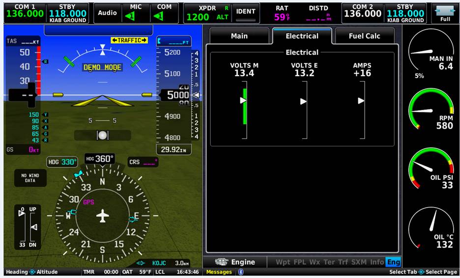

I have updated the Load Analysis to reduce confusion. I have removed the MAX DRAW columns (required only for the local European Load Analysis). I hope, it's more clear now.
The updated analysis will be posted soon in my original post.
The euipment outlined in the Load Analysis is required for the night IFR flight and will be ON.
Let's focus on the el. diagram. I am going to replace the ESS-BUS relay with a continuos duty type relay.
Have you found any other hotspots?
Is there any G3X Touch expert who can tell me if it's possible to setup the warnings in the G3X Touch for the Voltage as described in my OP?
Igor
RV10 in progress
Kellym

Snip from my original post:
Respective BUS voltages monitored by G3X Touch.
-MAIN BUS threshold monitoring at or below 13.8V triggers (MASTER CAUT) MAIN BUS LV
-ESS BUS threshold monitoring at or below 13.0V triggers (MASTER WARN) ESS BUS LV
Igor
RV10 in progress

PostPosted: Mon Jan 14, 2019 9:37 am    Post subject: Basic Elec. Diagram -critique pls Reply with quote
Igor section 18 of the G3X installation manual has all the information for configuring your EIS. While the G3X does support display of 2 different voltage sources, it will combine them on one gauge. This means that your Master Caution alarm and Master Warning alarm thresholds will have to be appropriate to both voltages. I recommend you do not set any Master Warning, and set your Master Caution alarm to ~13.7 V. If either bus falls below this level, you get a warning and can plan accordingly while your battery is still fully charged.
On Mon, Jan 14, 2019 at 6:11 AM supik <bionicad(at)hotmail.com (bionicad(at)hotmail.com)> wrote:

PostPosted: Mon Jan 14, 2019 9:40 am    Post subject: Basic Elec. Diagram -critique pls Reply with quote
My G3X install manual is out of date. It's possible the 2 voltages can be split to 2 different gauges. Check section 18 of your install manual and if possible try it out on an existing installation with 2 voltage inputs. You may be able to set the warnings up as desired.
On Mon, Jan 14, 2019 at 9:35 AM Sebastien <cluros(at)gmail.com (cluros(at)gmail.com)> wrote:

PostPosted: Mon Jan 14, 2019 9:41 am    Post subject: Basic Elec. Diagram -critique pls Reply with quote
Also the labels available are Main Bus and Aux Bus or Bus 1 and Bus 2. You may want to go with the latter for clarity since an ESS bus is definitely not an AUX bus.

Thanks Carlos, I was afraid, the system will not allow labeling the ESS BUS.
Igor

I have just received a picture from G3X Expert. Apparently it is possible to label the indicators..

cluros(at)gmail.com
PostPosted: Mon Jan 14, 2019 3:53 pm    Post subject: Basic Elec. Diagram -critique pls Reply with quote
Please post the picture and your install manual.

Carlos, the picture is uploaded in my previous post.. You can download the current manual directly from the Garmin website.

cluros(at)gmail.com
PostPosted: Mon Jan 14, 2019 4:14 pm    Post subject: Basic Elec. Diagram -critique pls Reply with quote
Since they can be displayed as separate gauges, you will be able to set up your alarms as you wanted in your OP.
