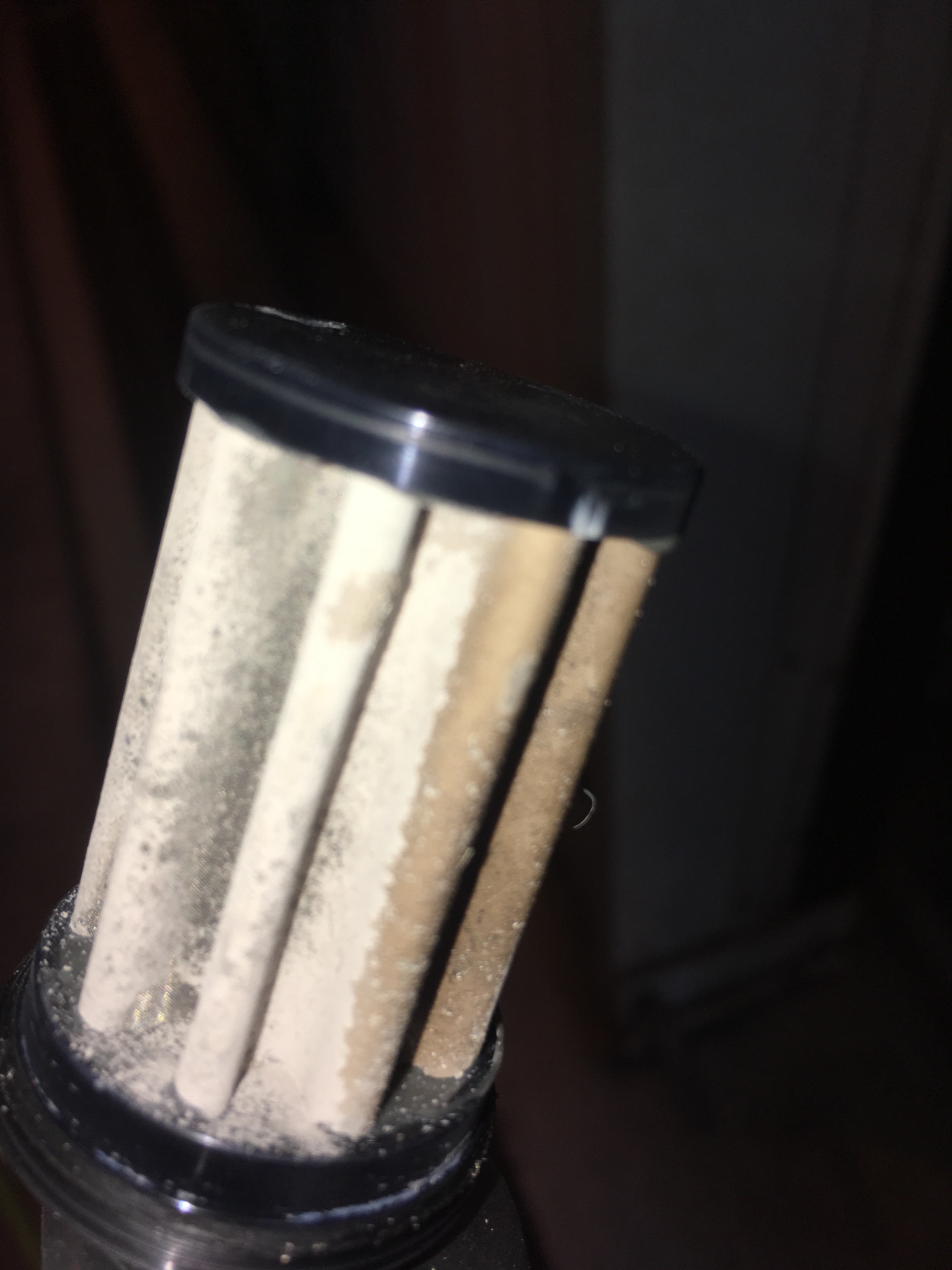

PostPosted: Wed Mar 27, 2019 5:32 am    Post subject: fuel filter Reply with quote
This is what our fuel filter looked like after about 350 hours.  We had noticed hot starts were getting harder, but no fuel flow issues at WOT or in flight.  We were pretty shocked by this when we saw it.  It is completely covered by a fine, white powder that came off with compressed air. Made a remarkable difference in starting behavior.  Well that and the Surefly ignition Wink
Plane lives in a hanger and flies off of a paved runway.
Sorry, I don't have any after photos.

flysrv10(at)gmail.com
PostPosted: Wed Mar 27, 2019 5:42 am    Post subject: fuel filter Reply with quote
must have had contamination in the fuel tanks to begin with.

PostPosted: Wed Mar 27, 2019 6:38 am    Post subject: fuel filter Reply with quote
I this points out that the first couple condition inspections should have a check of this filter. After that, base interval on previous results.
I don't think it is a good idea to go much past 100 hours before first inspection of the fuel filter, because of likely fuel sealant or other contamination bits coming out.
