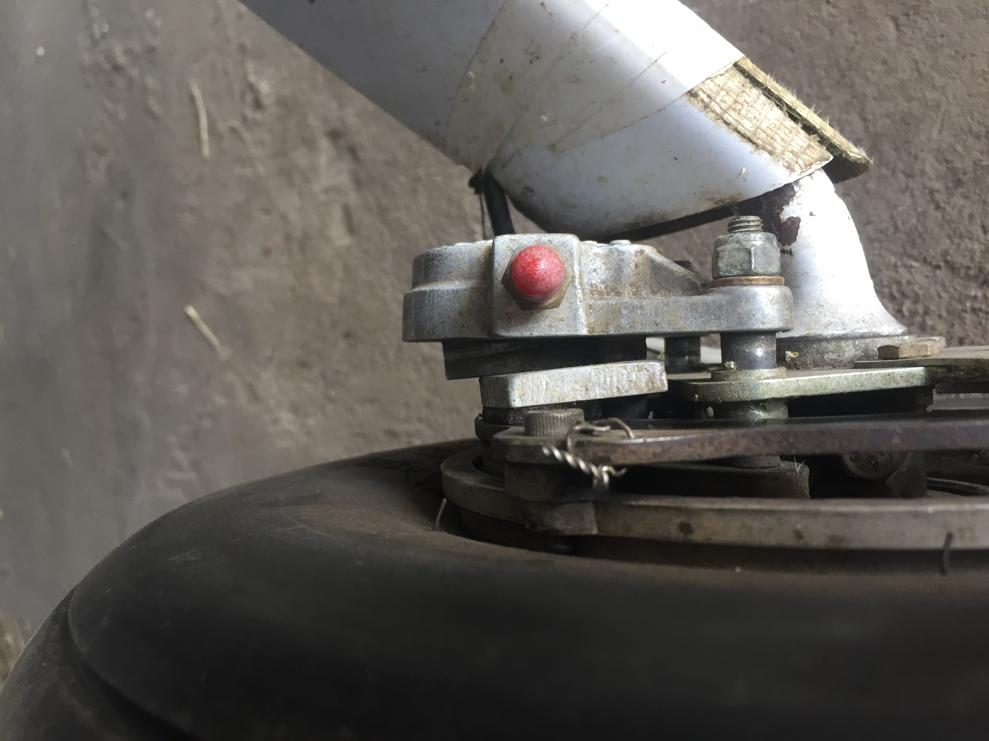

diamond
Joined: 21 Apr 2019
Posts: 25
PostPosted: Sat Jul 13, 2019 1:19 am    Post subject: Re: brake locked Reply with quote
For me was a sunny day but not very warm...
A friend of me has the same problem...
In my mind it’s the park brake box (pvpv-d for matco system)
I’m curious to know how it works...
But in general the europa brake system conception seems to be poor...
I’m surprised to see a twisted caliper piston pushing on only half a pad...

diamond
Joined: 21 Apr 2019
Posts: 25
PostPosted: Tue Jul 30, 2019 2:25 am    Post subject: Re: brake locked Reply with quote
Thanks for you response all together. I’m planning to have a quote from beringer, but it could be available only in september...
Sad
waiting for that I could replace the liquid, but how to open that reservoir...?
 Filesize:  29.12 KB
 Viewed:  15139 Time(s)
Ivor
Joined: 23 Jul 2015
Posts: 51
PostPosted: Tue Jul 30, 2019 3:26 am    Post subject: Re: brake locked Reply with quote
The red bung is the filling point, or remove the complete top using
7/16 spanner
