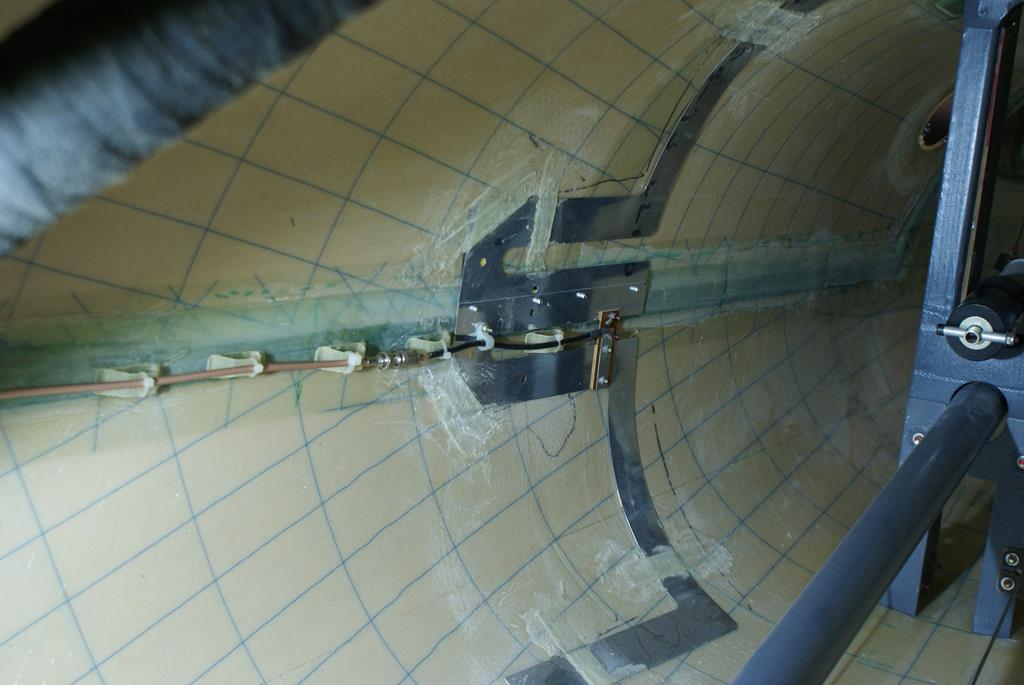

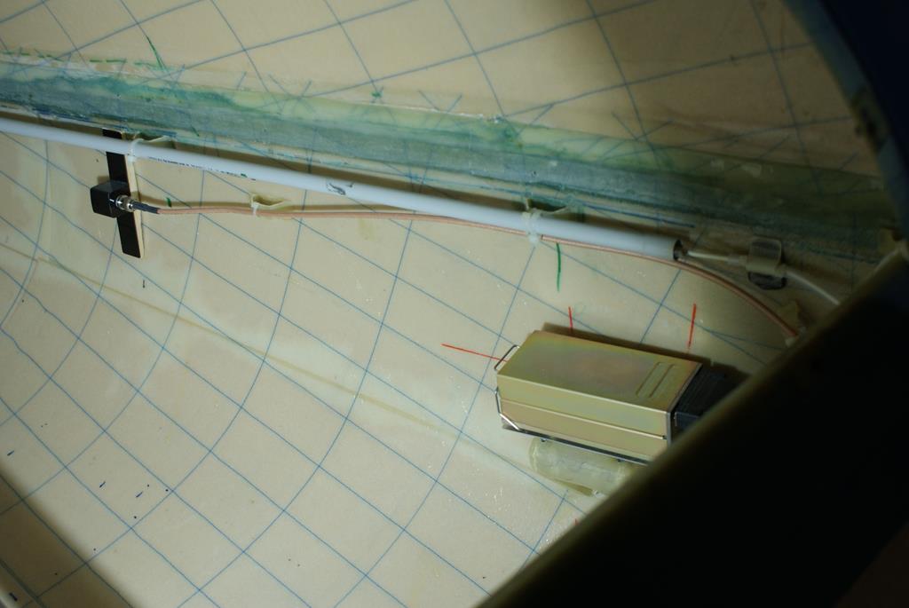

Hello Emmanuel
Look attached photos. Two dipole antennas inside the fuselage, very short
coax cable the the TRIGs, works perfect.
Best regards, Ruedi HB-YJF

PostPosted: Wed Oct 09, 2019 10:45 pm    Post subject: best radio and transponder emplacement Reply with quote
Trig radio box in panel aerial in rear fuselage.
Trig transponder box in panel aerial right at back of fuselage.
Both work well with long cable runs
