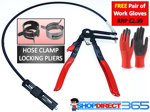

Hi Paul
The coolant oil and fuel pipes are all available online easily enough.
The carb stuff from someone like Eccleston Aviation.
You really need a set of long reach clamp pliers to make the job easier. They are around £10 on ebay.
The coolant hoses are a pain and I found it easier to undo the intake manifolds……..they  are on o rings so no worry about needing gaskets to refit.
Allow a good half day for it.
