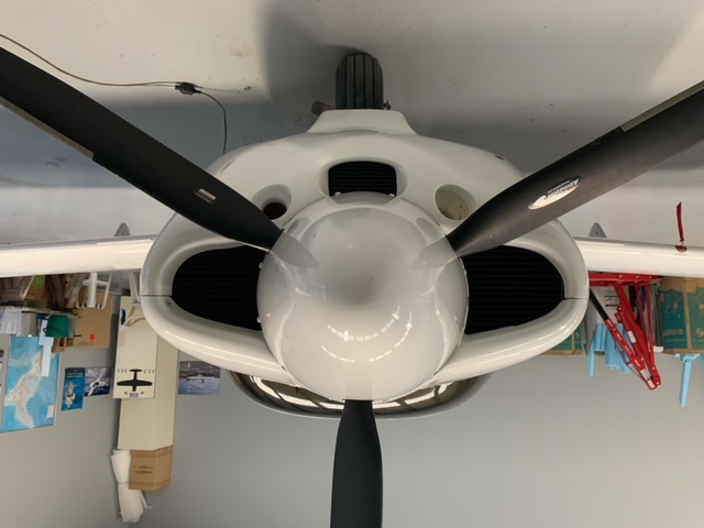

Hello fellow Europa enthusiasts!
I'm trying to solve the oil cooling issue in my 912 ULS powered Classic. I have the standard cooling setup with a 10 row oil cooler behind the port radiator and slightly enlarged cowl outlets. On hot days (30 C) and loaded to max weight I very quickly reach 120 C oil temp during a climb of just 2000 ft. If I let it cruise a bit it will go down to 115 C within a few minutes, 110 C if I reach cooler air higher up. The coolant stays below 90 C, except the climb phase where it reaches around 100 C. So far after reading your past discussions I came up with 2 possible solutions:
1. Moving the oil cooler below the spinner.
2. Installing an oil/water heat exchanger to supplement the oil cooler.
The first is a bit invasive and as I'm not the original builder I don't feel fully confident to perform, yet. The second one is tempting but I thought about trying a simpler solution first: exchanging the oil cooler for a larger model. Mocal makes various sizes - the 13 row should fit without issues and perhaps the 16 row version will fit as well (if it can clear the exhaust pipe).
Has anyone tried this approach? How effective this may be without enlarging the cowl outlets? According to charts on Mocal website I should expect a reduction of oil temp of around 8 C (16 row vs 10 row), but that assumes a free air flow which is most likely not the case inside the cowling.

Hi Michalm,
Best solution is to reposition the oil coolant below the spinner. An alteration to the lower cowl with a inlet for the oil cooler. Easily done with composite experience or get someone to do it for you. No bull nose required just keep with the original profile. See photos. I have to place a barrier in winter to keep the temperature up 110C Rotax prefers the engine to run at. Works very well.
Cheers,
Tim

The repositioning of the oil rad is called the tropical chin mod, here’s the link for the UK LAA Mod
http://www.lightaircraftassociation.co.uk/engineering/Standard%20Mods/11362%20Chin.pdf
Hope this helps

My original solution was to install the original oil cooler under the spinner without a chin scoop.
The client made no attempt to duct out the bottom. In a test it was fine so he flew like that for years until selling the plane.
It worked better than behind the glycol cooler. The LAA mod is better as it allows for more room under the muffler for proper ducting.
In "Cooling 102" for the Jabiru, I show a duct arrangement, I've had excellent results making the climb oil temps behave. A bit cool on cruise but 180 F in summer at 7500 feet is not unacceptable. It runs too cool in the winter without a plate on the front or better yet a cowl flap to control oil temp. Same idea can work in the Classic, but it is tight depending on your muffler arrangement. The same technique is used in the LAA mod for the inlet.

Tim, your modification looks interesting and not very intrusive. Thanks for the photo.
