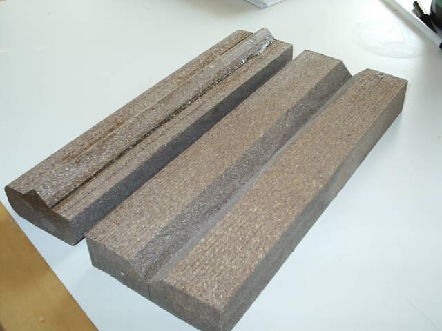

Posted: Fri Jul 28, 2006 4:53 am Post subject: Hat Stiffener Press + Pic of the day |
After a few failed attempts at making hat stiffeners for the main spar, I decided to try making a press die for them in much the same way I made my flanging dies. Here's what I came up with. I used the same timbertech composite material as I used for the flanging dies, and was able to fabricate the whole set using a table saw and some 5-minute epoxy from ACE hardware. I rounded all of the corners to the proper radius, and epoxied the male 45-degree press flange to the top die. To use them, I put a piece of .025 between the dies and put them under pressure with the shop press until the bend is formed, then trim the flanges to the proper size. Out comes perfectly shaped, high-quality, repeatable hat stiffeners lookin' like the factory made 'em.

Debo, I've said it before, you're a genius. What a creative use of plastic lumber.

Messages like this one are why I stay on this list. This one is a gem. Bravo. I would never have thought of that.

Did you engineer this to take into account spring-back (i.e. did you add more angle to the bends)?

Thanks for the kind words. I've used your web site for inspiration and ideas a lot - so right back atcha.
I didn't add any angle for springback, and haven't found any to really be necessary. I suppose it's because the part is being pressed out under pressure, but it doesn't seem to be a factor - at least with mine. I'm not sure if it was just dumb luck, or my, uh, "engineering", but I suspect the first one.
The whole setup was really easy to make - took less than an hour, and I even screwed up a couple pieces of material trying to get the dimensions right. The first ones I tried to make on my brake were a disaster, so this seemed like a workable alternative. I've made a complete set for the right wing so far, and it's so far, so good.

These really are a nice set of dies Debo.. I hadn't thought of using the
plastic deck material.... This type of die would also work for a lot of
other things too. Like the relief beads on the gas tanks..... fair lead
pieces for cables, and might even work for the hat stiffeners on the
floor pan of the 701. I wish I had seen your dies, before I purchased
mine for the 701
Monty Graves

Yup ... purely speculating, I would say this general technique could
probably be used to make very clean joggles on longerons by making
male and female forms that cuddle the angle securely on all sides with
sheetmetal shims glued to the faces to do the joggling. -- Ihab

You are the master. I had someone offer to buy my flanging dies the other day, which I declined, and I refered him to your pics.
You might wanna take a look at how I solved bending the flaps. The final 163 degree bend was done with the 200lb gravity actuated stomp press

Thanks guys. I'm glad the press idea sparked a little head-scratchin'. That's the really cool thing about this list. One guy finds a way to get himself out of a pickle - shares it, and gets a dozen good ideas back in the process. And you thought the internet was just good for lookin' at porn.
Ron, I laughed out loud like a moron when I read about the "200lb gravity actuated stomp press" - classic.

I started to design the exact same thing last night. Good to see it works. My only question, do you have any spring back in the angles or contour the exact same as the part specified in the plans? I was thinking of making one with spring back built in but it may not be necessary. I'll try this frist because building in springback is a lot more work and if it doesn't need it that'd be great.

I used the same gravity actuated stomp press for my rudder skin and elevator skin. Can't beat the price.
