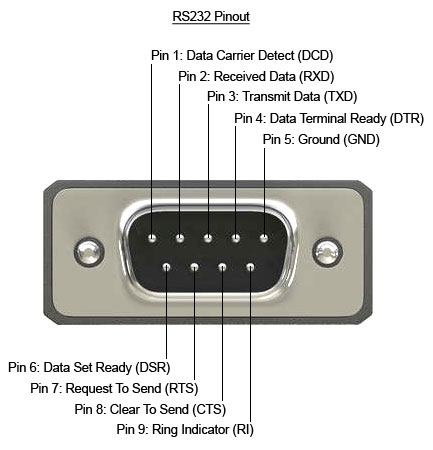

If it is a standard RS232 connection, pins 2 & 3 are your transmit and receive signals.
 Filesize:  30.71 KB
 Viewed:  4633 Time(s)

PostPosted: Sun Jan 16, 2022 2:37 am    Post subject: Reverse Engineering JPI Engine Monitor Interfaces Reply with quote
From what I remember from an aeroplane I sold 15 years ago this is a straight RS 232 interface but the serial to USB converter is key, not all work. Don’t forget to switch the Rx & Tx pins on the way to the computer. I believe it is only a 2 wire interface, so I’m guessing the Rx (3) and Gnd (5) pins (at the computer end) are connected?
