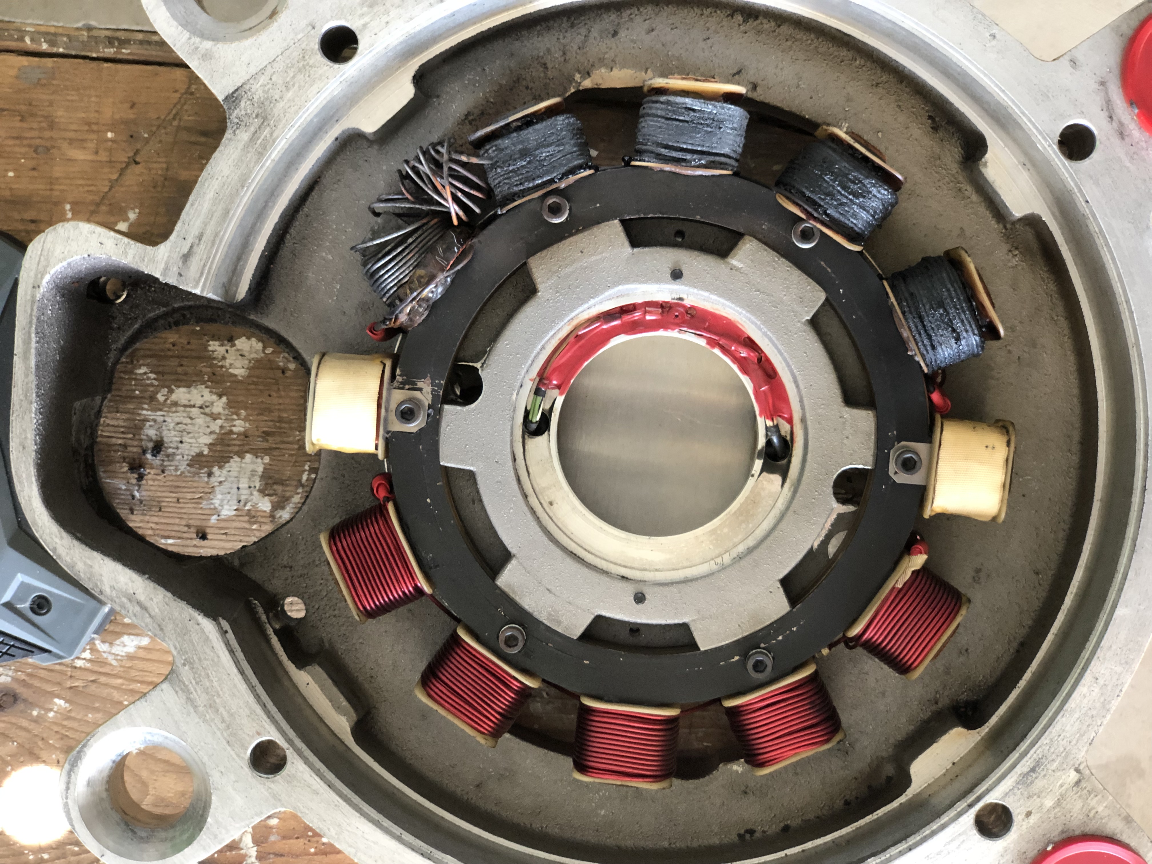

PostPosted: Fri Jul 08, 2022 1:05 pm    Post subject: Thermocouples: grounded or ungrounded Reply with quote
[img]cid:ii_l5cxf3460[/img]
Bob
I agree with what you are saying concerning the ideal method of monitoring the coils.  However I need to work with what I have and I don't think I can monitor 12 individual coils with the tools at my disposal.  I do plan on using your idea of the rotary switch and I appreciate the schematic.  I thought all might be interested in a picture of the stator after removal.  The one coil suffered catastrophic damage with the phenolic spacer completely destroyed by the heat.  I have machined the case to allow more ventilation and will add two blast tubes directly at the coils.  And hope for the best.
Paul
I did check with GRT and their EIS/ EFIS cannot read thermocouples except through the 4 or 6 EGT and CHT inputs.
On Thu, Jul 7, 2022 at 3:22 PM Robert L. Nuckolls, III <nuckolls.bob(at)aeroelectric.com (nuckolls.bob(at)aeroelectric.com)> wrote:
The most important temperature readings will be of the stator.
   yeaaahhh . . . sort of. Temperature numbers of the stator
   stack adjacent to mounting bolts will be greatly
   influenced by heat transfer to the crankcase.
   We know that the stator failures are generally limited
   to one pole. How do the wires look on remaining poles?
   To precipitate this 'isolated' failure suggests a thermal
   runaway event where the resistance of copper rises with
   temperature which in turn, increases energy dissipated in
   the wires. I.e. a positive feedback for temperature
   excursion.
   To catch a pending failure suggest a need to monitor
   each winding . . . unless field experience shows that
   failures are concentrated.
   In any case, other temperatures around the system's
   components may be interesting data but I'm skeptical
   as to their ability to flag impending failure any
   one coil.
