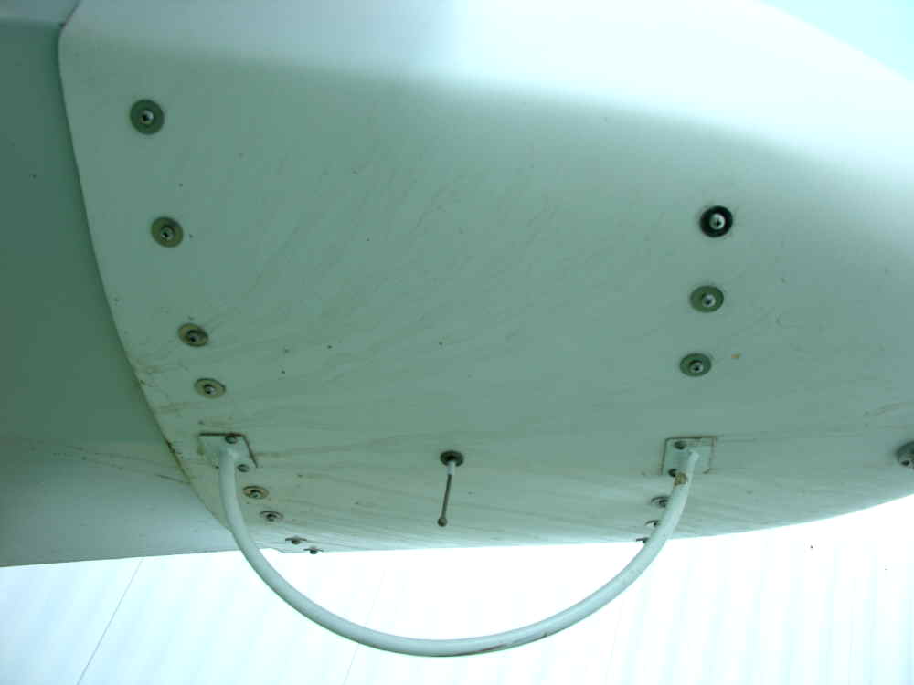

dhkey(at)msn.com Guest
Posted: Sun Jul 30, 2006 3:15 pm Post subject: RivetNuts for the nose cone |
I want to be able to take the nose off without drilling everything out. Do
you have photos of the AN366F anchor nuts being used?

biglar
Joined: 14 Jan 2006 Posts: 457
Posted: Sun Jul 30, 2006 6:04 pm Post subject: RivetNuts for the nose cone |
I just went out and took a couple of pics. Let's see if I can still attach
'em here......... Sorry - Vamoose needs a bath, but that'll come.
