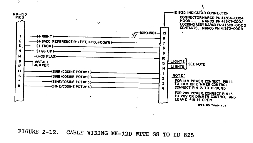

I happen to have a Narco ID-825 indicator that can display VOR/LOC/Glideslope. I can't find and technical info on it. Can anyone tell me if this indicator contains an internal VOR/LOC "converter". My KX165 nav/com with glideslope has its own converter and therefore needs an indicator without the converter. It would be great if I can use the ID-825 with the KX-165.

At 04:00 PM 2/26/2023, you wrote:
--> AeroElectric-List message posted by: "Radioflyer" <skyeyecorp(at)airpost.net>
Information I can find on the ID825 suggests
that the ILS display consists of generic
cross-pointers, integrity flag and VOR
resolver.
No 'active electronics' included . . .
out of that stuff?"

Thanks for taking time to look into this. It may work, though it is looking like I'll need an avionics shop with old manuals to derive an actual pin out from the King radio to the Narco indicator. Seems like they use different names for probably the same signals. Oh well, it be easier to just source a KI206!
