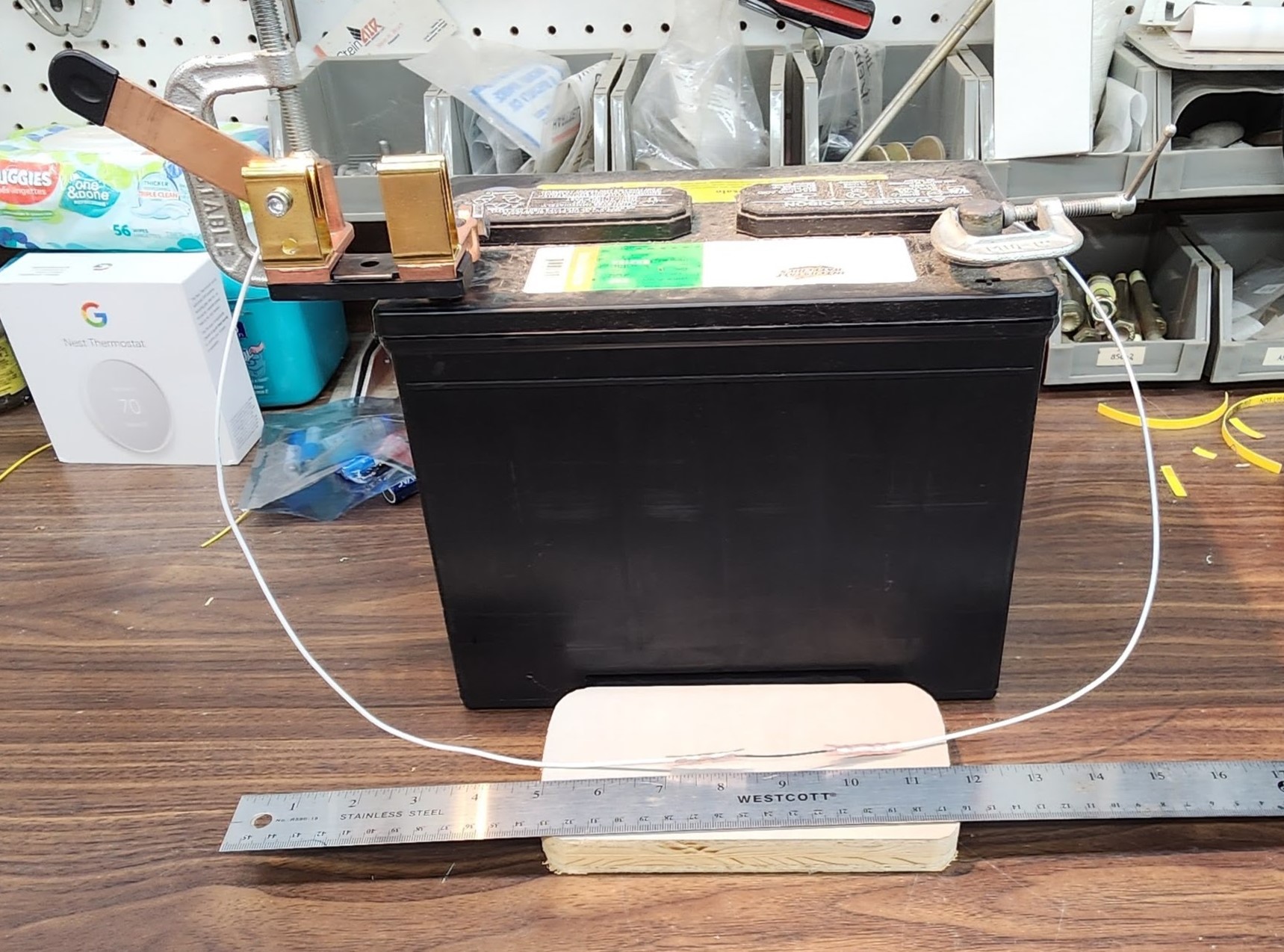

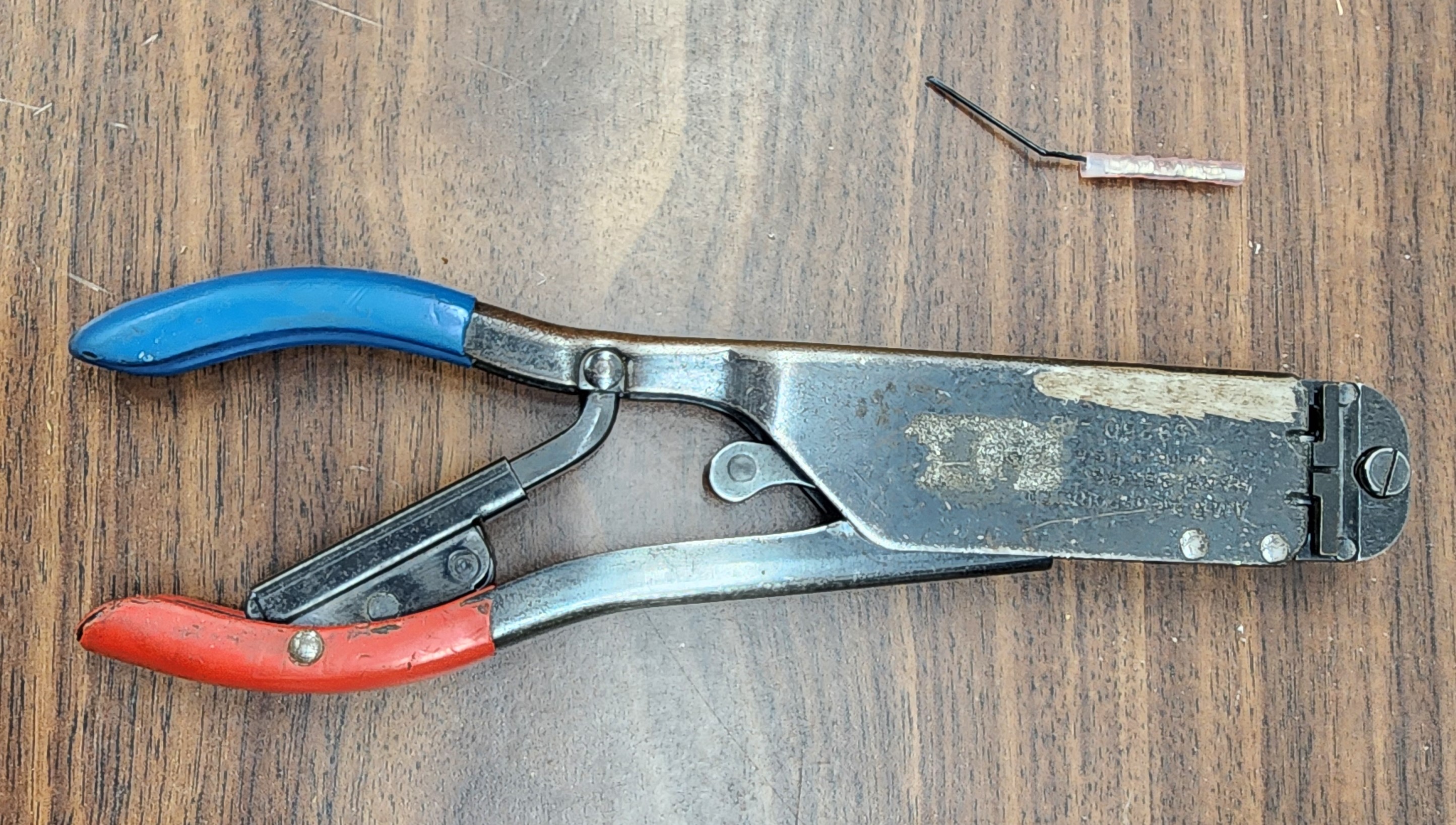

My very basic test rig with somewhat empirical results- no measured data.
Objective: observe failure of fusible links of various lengths when subjected to a high current short circuit event.
12V wet cell, new, fully charged battery
Knife switch
18 ga tefzel feeder, 20" length x2
PIDG style butt splices (red)
Camera
DUT: 2", 6", 13" lengths 24 ga tefzel FL (M22759/16)
Procedure:
Fabricate fusible links of 2, 6 an 13 inch lengths
Crimp w/ AMP PIDG crimper to
Feeder 20" 18 ga tefzel
Clamp feeders to B+ Knife switch and B- battery terminal
Start camera video
Rabidly close switch
Two inch FL setup
[img]cid:ii_lqo7bxra0[/img]Crimp tool and butt splice
[img]cid:ii_lqo9ivb81[/img]
results:
http://tinyurl.com/mryadbfx
No fiberglas sleeve was used so that failure could be observed.
Comments, questions, critique!
...chris

That's a great demonstration Chris.
And it evidences exactly why I would not use fusible links in an aircraft, or automobile for that matter.
There's smoke, there's fire, and there's molten metal!
With most fuses the burned wire, smoke, and fire are contained.
Cheers! Stu.

Chris' demonstrations are essentially the
same as those I conducted 23 years ago
when this article was published on
the website.
https://tinyurl.com/msx5ofe

What I found very interesting is how often the melt/disconnect occurred near the butt splices.
Seems to negate the theory of the splices and bigger wire leading away the heat needing to melt the wire.
Any chance that you "nicked" one or more of the strands when stripping the insulation?
Would be interesting to see the same experiment with soldered connections.
Finn

Back to the original question of the length of a fusible link. That is the length of smaller gauge wire comprising the 'link'.
  Had to do some 'digging' to see if I could
  find where that 3-6 inch citation came from.
  No joy.
  Actually, 6" is the minimum. 9" is more typical,
  10" not unheard of. 3" is too short . . .
  . . . and INSULATED with material resistant to
  energy released by clearing the fault.
  See:  http://tinyurl.com/4vnzdjpc
