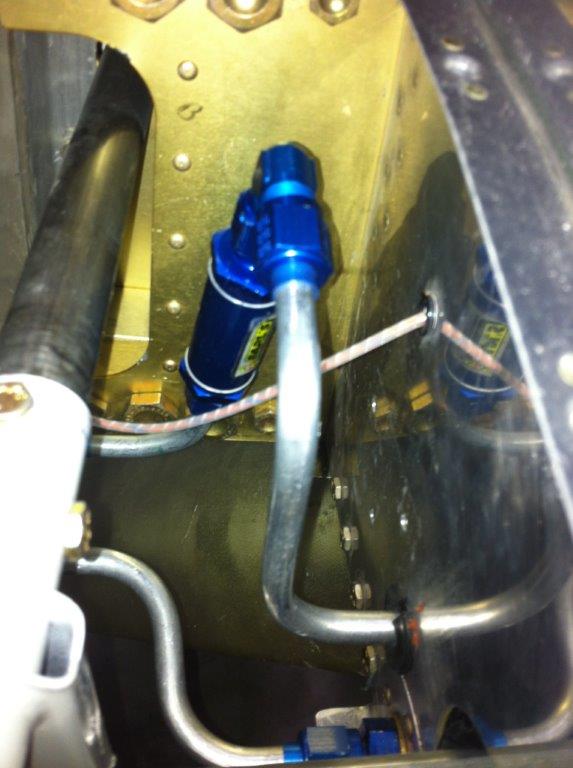

Agree with David's comment on the fuel filters. One of the "legacy" items from my earlier filters install was placement of fuel filters in the wing roots. I was able to install two Earl's Performance filters - one in each wing root. They are user serviceable and easily accessed simply by removing the wing root cover panel. Now I don't have to contort myself to get at them as I would if they were in the tunnel.
Regular cleaning, especially when first flying, is a must. There can be a lot of accumulated crud when building.

These are what I used : http://www.summitracing.com/oh/parts/ear-230206erl
I flow tested them at something north of 50 GPH so they are well suited to our application (IMHO). The screens are easily removed and cleaned. I have done so several times.
When I first was flying, I had to install gascolators to meet inspection requirements. These I had in the wig roots and the filters were under the seat. Accessing them was a real pain. I wanted easy access. I certainly didn't want them in the tunnel.
When I received permission to remove gascolators, I moved the filters to the wing roots. Much easier access (5 minutes and they are both out).
Also, rather than ruin a solid line from the tunnel to the fuel tank, I ran the line to a bulkhead minutes on the fues sidewall. It was easy to mount the filter between this and the tank outlet.

PostPosted: Wed Mar 25, 2015 7:12 pm    Post subject: Re: fuel filters Reply with quote
Hi
As requested by Patrick, here is a pix of of my wing root fuel filter. I misspoke in my earlier post when I said I used a bulkhead union for the line. I didn't as I had a connection at the filter I could break. It is hard to see but I used a 90 degree AN fitting to attach the top of the line to the filter.
Lest anyone ask, the other line to the tank is a return line, another Subie legacy item that proved useful.
Cheers
Les
