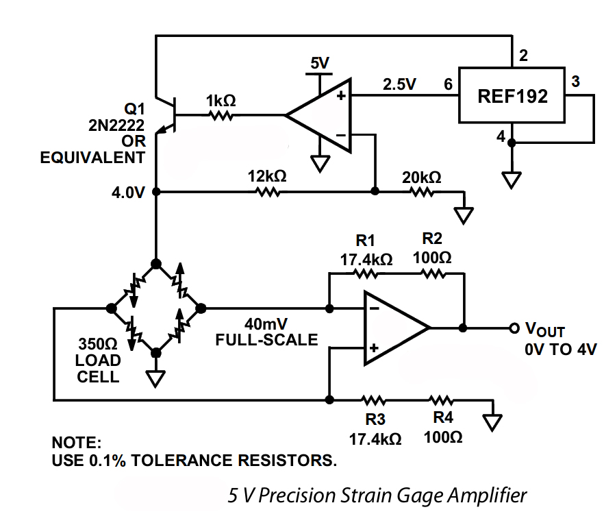

Last time I worked at those voltage levels
was to instrument some strain guages in the
pitch trim system of a Beechjet about 25
years ago. Chopper stabilized op-amps are
handy for this task. The parts I used back
then are long obsolete but Digikey has a
selection of modern parts:
https://tinyurl.com/23uwab99
Top one in the list seems a likely candidate.

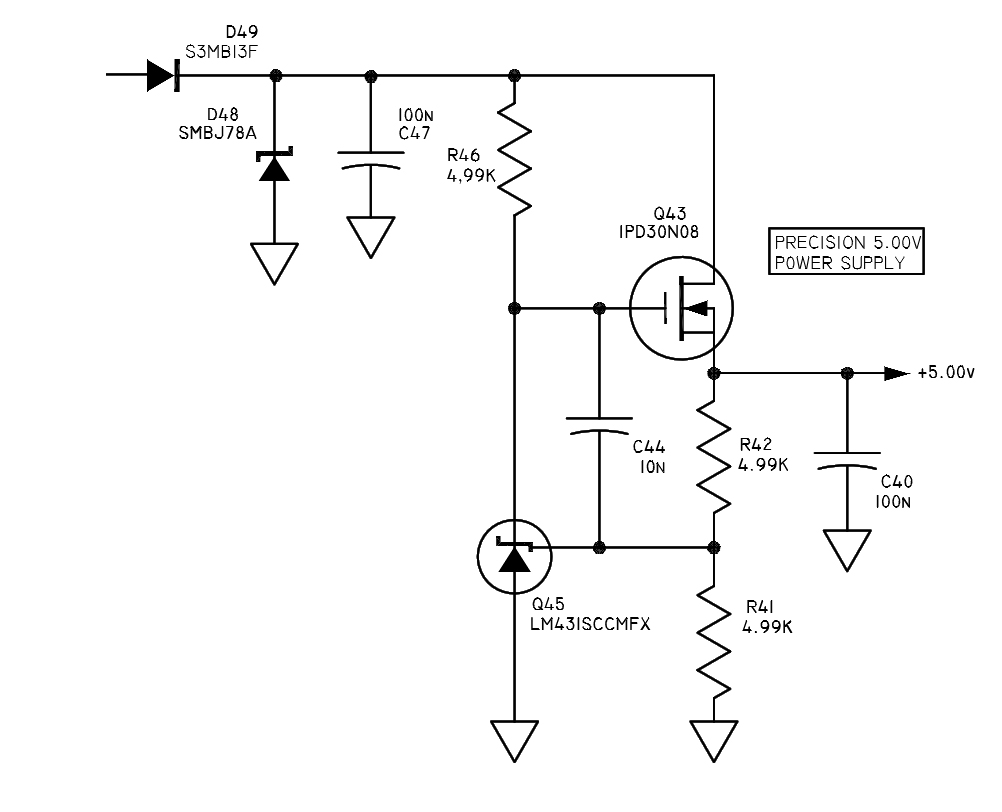

I've attached an exemplar circuit from one
of the data sheets. The precision voltage
supply is a bit arcane, my personal favorite
is also attached. One supply can be used to
power up the array of pressure transducers.
You might read up on using these high gain
systems for conditioning tiny voltages . . .
ecb layouts need some attention for
noise/leakage mitigation and compensation
for local Seebeck effects.
