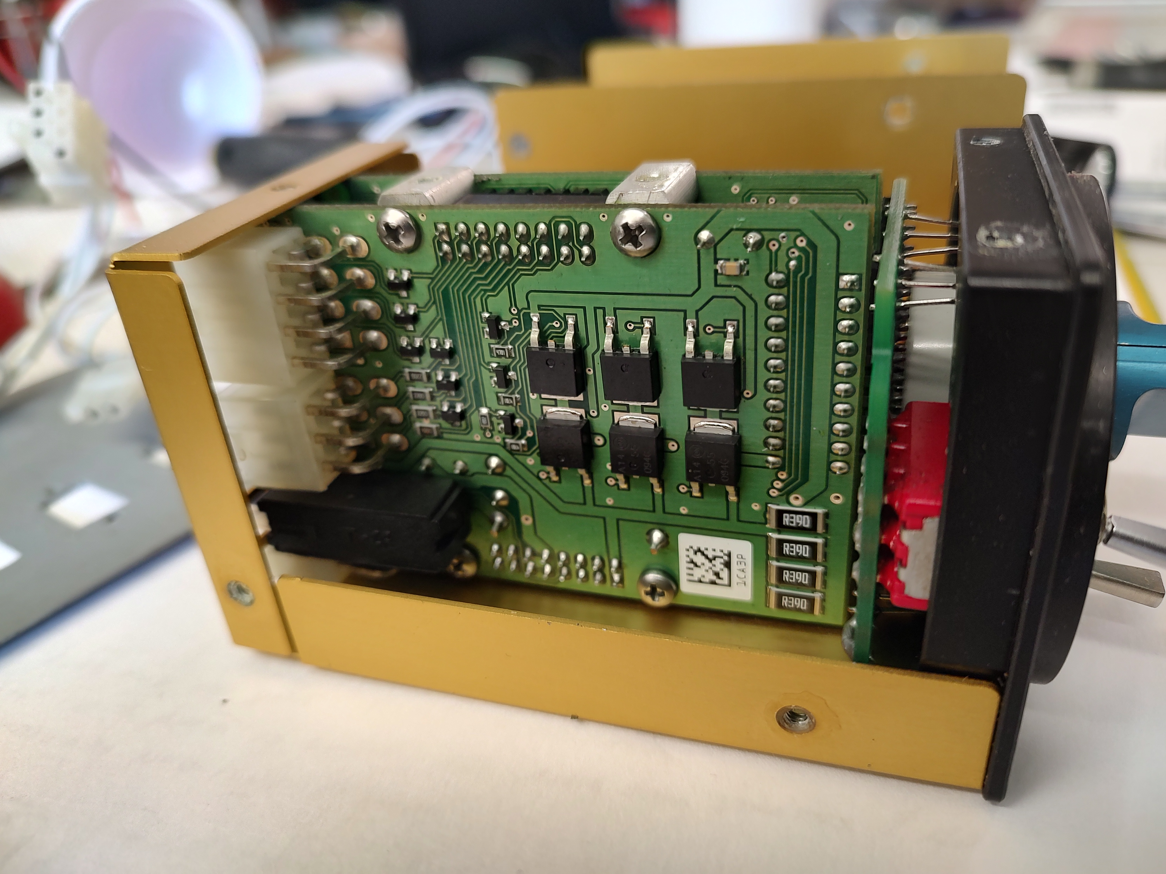

John to your particular electrical issue:
If you were able to install the USB to Serial cable and hook to your laptop successfully and make the RPM change it is possible during your hookup and removal of cables (especially in tight areas) a circuit board may be damaged. Circuit boards can be brittle although the AC200 has very robust connections, I can see how it will happen. For those who have never had an issue, here is what the inside of an AC200 looks like:
[img]cid:3f2455a6-672e-48fb-867f-4d40b648d6b6[/img]
One can see the pin connectors are quite robust but again, they are soldered, and a solder joint can break, or some part of the joint or board flake.
My concern with locking plugs is the Molex style connectors can be a pain to lock in and unlock. I no longer just plug in a Molex until I can see if I can release it easily but still remain secure when clicked in. Heat shrink is normally placed on the end of a Molex connector and unfortunately the heat shrink wraps under the push to release lever and can prevent full depression of the lever and may prevent an unlanch for removal. I trim the heat shrink to assure the hook side opens with clearance to spare. If a plug gets stuck, I suggest to the client to bend the hook side to assure it clears the latch and it should allow the plug to slide out easily rather than trying to trim the heat shrink in place. In trying to remove the larger connections sometimes torque is applied to the molex and the results can be terminal. I have also seen the power plug leaned on heavily and the ground and or power connection solder joint causing a broken board or failed joint. In my autopsy of this AC200, a small chunk of solder was found and it shorted on the board. (Even though the board is vertical, and one would think the solder would simply fall to the bottom. He was unlucky as it caused a short of course. However, most of the time a fried controller was a power connected to the ground and vice versa. OOPS. As my friend Gary would say... I'm going to pay the dumb tax for that." We've all been there.
Although I have never had this issue like yours, for servicing I make all my panels easily removable and put the panel on the bench (sometimes I remove the AC200 from the panel and do the update process on the bench).  I hook up my USB serial converter to my laptop, turn on the computer, call up the program and power up the AC200 and I've never had an issue. The software comes up (once I figure the com port on older non- automatic external USB connection programs) I change the item on the screen and then close the program and power down the AC200.
It would be nearly impossible for a digital to serial conversion cable and processor to fry anything in a working propeller. So, I am sure it is not the cable. As for other issues. If the prop was working before, I am stumped and blaming you, Airmaster or anyone else is inappropriate with what information I have read on your issue.
There are other means of frying electronics though.
