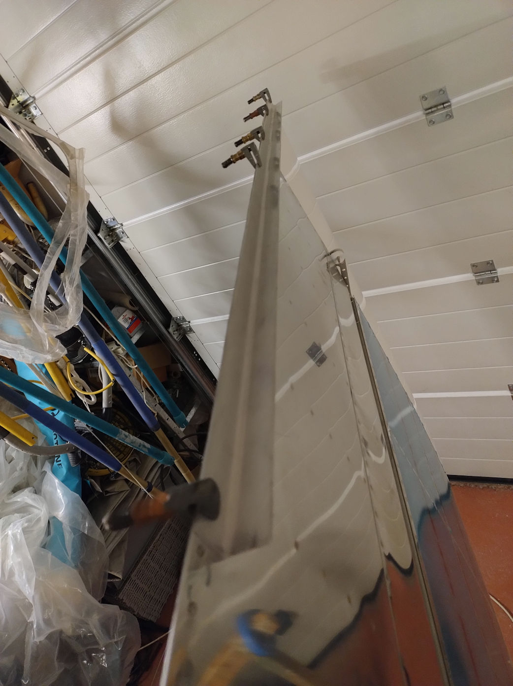

I know this list is no longer as active as many are on facebook now.
Just wanted to share my experience with the wingtips.
This huge flimsy items can slightly rotate inside the rib when mounting and you end up with a misalignment at the TE. After flaps are in reflex and the aileron securely clamped I did add an angle at the TE extending far out, I then pushed the wingtip in and clamped that TE as well to the angle by pushing down. Best a 2 person job to get everything properly aligned but with that you end up with a straight line from fuselage to the tip.
Hope it helps
Werner
