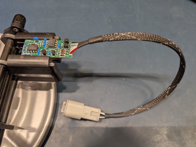

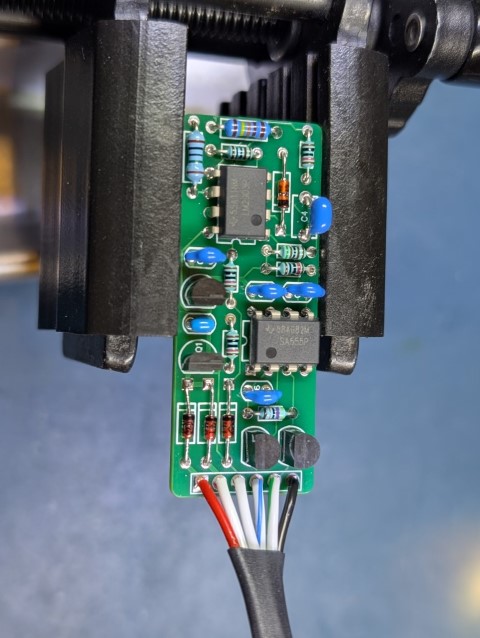

Now that the forum is back online, I can report that the second assembly of this project was completed and successfully tested a couple of weeks ago.
Its "+24V_A" and "LO_SNSR" pins were connected to +28VDC. When the "LO_SNSR" pin was made open circuit there was a 21 second delay then the module began flashing its "LED+" output at ~1.5Hz, and its "EFIS_ALM" output pulled low. The "LED+" output sourced 20mA, even into a short circuit. Reapplying +28VDC to the "LO_SNSR" input caused the "LED+" output to turn off and the "EFIS_ALM" output to return to a high impedance state. Behavior is identical when powered via the "+24V_B" pin.
See the attached photos showing the bare board as tested, and the finished module as shipped to Pete (minus adhesive-lined shrink wrap over the board).
