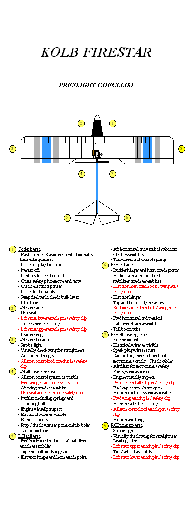

Posted: Thu Aug 03, 2006 5:59 pm Post subject: Check List |
David,
I picked this one up off of someone's website I don't remember who's....
Hope it helps..
Mike
