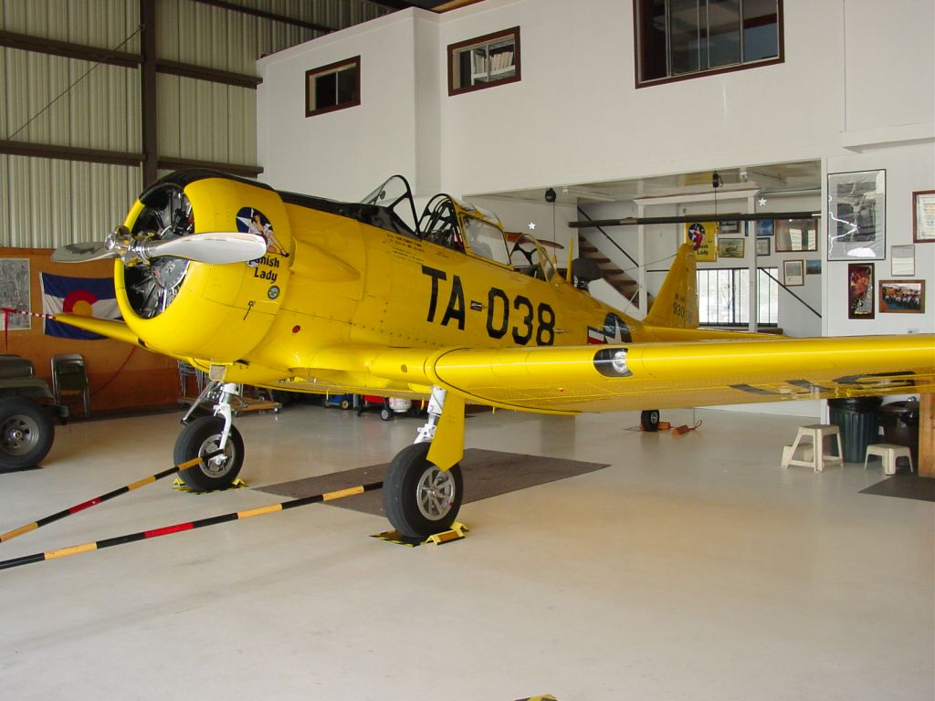

I've attached a picture of the AT-6. The pilot/owner is Dick Jones. The
plane is "The Spanish Lady" and it is beautiful on the ground and in the
air. Unfortunately, he must sell it due to high fuel costs. Anyone want to
upgrade?
