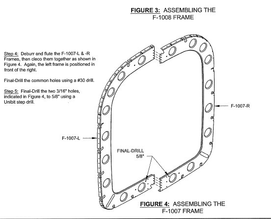

I'm assembling the tailcone on my -10 and came to a question in the instructions. On page 10-4 steps 3,4 the instructions say to assemble the frame halves with the left half in front of the right half. Meanwhile, the picture shows it the opposite of that with the right half in front of the left half. Anybody else stumbled upon this???

I have that page of the plans dated 9/16/03. The plans are correct, as well as the picture. I can't see any issue there.
(Hint: the flanges point toward the front of the plane, so the left is indeed in front of the right in the aircraft)
Attached is the figure from my plans.
-Jim 40384

It's okay in the plans. Mine are dated 9/16/03. It all depends on what the "front" is. Look at the wire frame picture at the front of Section 10 and you'll see that the flanges are pointing towards the front of the plane, which is always the definition of front. Took me awhile to figure that out, too.
John Jessen

Thanks John. Next time I'll look at the plans better.
