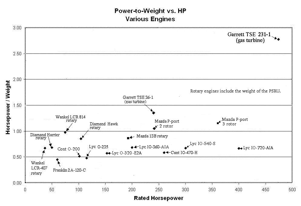

ddcuster(at)wmv-co.us
PostPosted: Fri Sep 22, 2006 6:59 am    Post subject: IO360 Reply with quote
You appear to be about where I am.
I looked at all the options. I am going to go with a Mazda 13B rotary engine.
Pros:
1. It has a history of robustness and resistance to catastrophic failure. NASA estimated that TBO would be 3000 hrs. Some vendors say 1500 hrs. No one really knows. One fellow flew his at reduced power (30 miles if memory serves) to a safe landing after loosing all the coolant (forgot to tighten a hose clamp - overhaul was ~$500). For me, this is the primary reason.
2. It's firewall forward weight is about the same as the Lycoming O320 that Van recommends. See attached chart (the chart includes the PSRU but I am not sure what else).
3. The p-port version has been dyno tested at 240 hp!
4. It is smoother than any 4 or 6 cylinder piston engine. No reciprocating parts. Much less vibration and shake.
5. It runs happily on 100LL, 87 octane mogas, and, with the proper fuel system gas with alcohol in it (Brazil requires 20% alcohol). Some builders, including Tracy Crook, use mogas almost exclusively.
6. Low cost. Initial cost will depend a lot on how much you use custom accessory parts. Bare reman engine is $2,000 to $3,000 depending on how many new parts are used. My local Mazda dealer quotes $2,000 plus $1,000 core charge (all parts are new or meet Mazda new specs). Overhaul is typically $500 for parts. If you can find a used engine you can overhaul it yourself.
Cons:
1. It uses about 10% more fuel for a given power. But if you are willing to use mogas, currently more than $1 less expensive, the fuel cost is actually less.
2. You will have to educate yourself and make a lot of component choices. Lots of help on the net, you will not be alone.
3. The apex seals are lubed with 2 cycle oil. Either in the gas or by injection pump. I regard this as a nuisance.
4. It has a reputation for being exceptionally loud but that seems to be for the unmuffled version. I have heard audio clips that allow you to hear the wind noise through the canopy using a proper muffler. One builder says his is the quietest airplane at his airport. Not sure what that means exactly.
Conclusion: the robustness is worth the extra effort and fuel. The power to weight is a bonus, particularly if you do mountain flying at altitudes over 14,000 feet as I do (my home airport is at 8,000 feet). Just don't exceed Vne.
For more information start at: http://www.rotaryeng.net
Doc Custer
Retired software engineer and sometime Audiologist
Building RV9-A. Fuselage
- The Matronics RV9-List Email Forum -
http://www.matronics.com/Navigator?RV9-List
