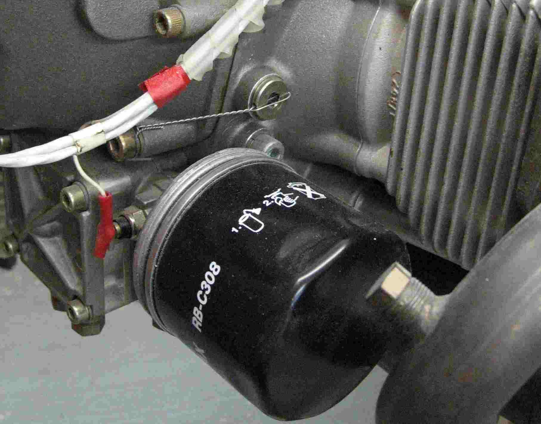

g-iani(at)ntlworld.com Guest
Posted: Fri Oct 20, 2006 12:32 am Post subject: IMPORTANT! - Release of MANDATORY Rotax ALERT SERVICE BULLE |
Alan
Your question "Where is this plug".
The plug is on the port side of the gearbox (centre of attached picture)
and mine is wire locked.
Ian Rickard #505 G-IANI XS Trigear
Europa Club Mods Rep (Trigear)
e-mail mods(at)europaclub.org.uk
or direct g-iani(at)ntlworld.com

jeff(at)rmmm.net Guest
Posted: Fri Oct 20, 2006 4:55 am Post subject: IMPORTANT! - Release of MANDATORY Rotax ALERT SERVICE BULLE |
Ian,
You may want to consider placing a large hose clamp around your oil
filter. Place the screw of the clamp to the front. The run your locking
wire from the plug to the screw on the clamp. This will safety wire the
filter as well. 2 birds with one stone as they say.
Best Regards,
Jeff
N128LJ / Gold Rush
