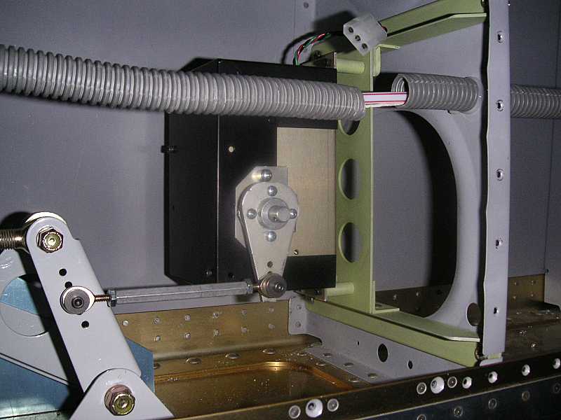

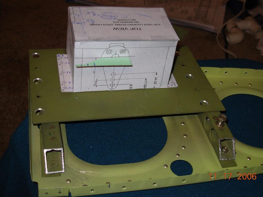

llsbiii3(at)netzero.net Guest
Posted: Wed Jan 31, 2007 9:16 pm Post subject: Trio Auto Pilot Servo |
Hi Scott,
I have attached two pictures of my solution and two pictures from others. Also check Sams descriptions at <http://home.hiwaay.net/~sbuc/journal/index.html>.
Let me know if you are unable to see the pictures.
