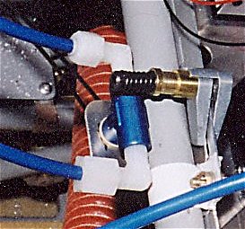

glastar(at)gmx.net
PostPosted: Mon Feb 12, 2007 8:44 am    Post subject: Static Air System - Alternate Air Valve- REDUX Reply with quote
Hi Richard,
hopefully attached, what I did (on a Glastar) a Curtis Drain Valve CCA-1550 together with a T and two elbows to fit the static line.
And I did an inflight check, error is 4 KIAS to high indication.
Werner

PostPosted: Mon Feb 12, 2007 9:32 am    Post subject: Static Air System - Alternate Air Valve- REDUX Reply with quote
Safe Air 1 has a kit <www.safeair1.com>
But, I like Werner's approach better.
Larry Rosen

LloydDR(at)wernerco.com
PostPosted: Mon Feb 12, 2007 11:07 am    Post subject: Static Air System - Alternate Air Valve- REDUX Reply with quote
It is basically the same thing, breaking the static air line, just one
comes with a streamer to pull, or am I missing something?
glastar(at)gmx.net
PostPosted: Mon Feb 12, 2007 10:13 pm    Post subject: Static Air System - Alternate Air Valve- REDUX Reply with quote
Hi Daniel,
yes, the SafeAir one seems to have a plug with a streamer attached, my
DIY one has a CCA-1550 <http://curtissuperiorvalve.com/pipethread.html>
which you push and turn to lock open (not visible in my last picture as
it it protruding on the bottom of my panel (below the alum. angle visible)).
br Werner
PostPosted: Tue Feb 13, 2007 6:28 am    Post subject: Static Air System - Alternate Air Valve- REDUX Reply with quote
Very nice, and eliminates the possibility of an accidental opening. I
wish I had known about these...I like the safe air method, but am
worried about where to put the streamer to make it accessible, but
reduce accidental pulling.
Dan
