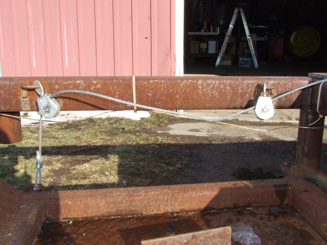

Here we are for the next to last photo detail. As mentioned before, I'll do some measuring and post the results.
First photo shows how the lift cable is attached and routed thru the pulleys. It is a continous loop from the left ramp to the right ramp with enough length to reach the front of the box frame where you can attach it to the winch cable.

Great photo sequence Floyd! Excellent job. I've moved them all to a folder for future reference and use if necessary. Thanks for keeping the photo attachments of a reasonable size. It was no problem for my dialup. Let us know how your first voyage goes.
