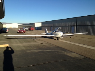

It seems that there is a Santa Claus! My airplane is back together after about 3 months of mod 78 work. I have attached a picture. I have a three day trip tomorrow, so the first flight should be on Monday.
The aileron quick connects seem to be clear of everything. The CS08 brackets clear everything. I am not sure if the flush screws were definitely needed, but the extra margin helps. It certainly helps in installing the wings. I was able to get them on the airplane by myself, which is a good sign.
The angles all seem correct, as far as I can tell. Just a few more parts left (wheel fairing) and that will make the test flight possible. I ran the engine today and it ran perfectly.
I'm planning a simple flight test. Maneuvers, stalls and a wind-up turn to at least 3 Gs. After that, pull the wings once again and inspect.
Airplane finally ready to fly after 3 months of mod 78

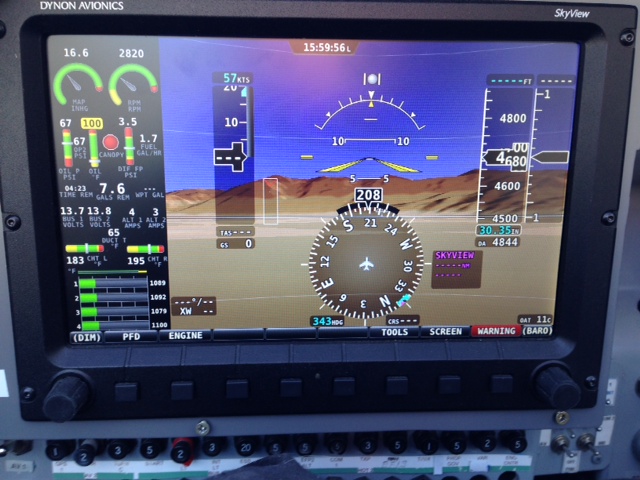

Engine run pre flight - everything perfect
