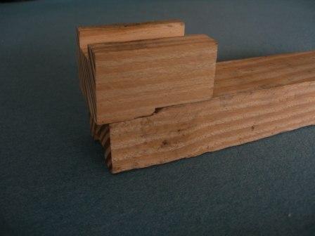

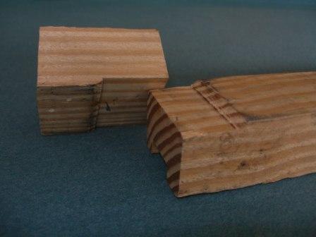

I made my joggling blocks from 1 1/2" x 2" hard yellow pine boards that were a part of the ZAC shipping crates. See attached photos. The offset is ~5/32" or 4mm by ~1". I placed the aluminum angle on the long block, end of angle flush with the end of the block. Align the top block with the joggle and give it a couple of sharp whacks with a mallet. Sometimes, I would clamp the vertical leg of the angle with another wood block to eliminate distortion of that leg. Questions?
Jay in Dallas

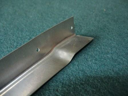

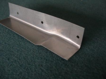

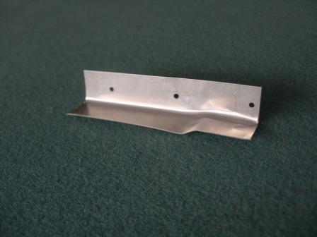

Jaybannist(at)cs.com
PostPosted: Thu Jul 05, 2007 9:29 am    Post subject: 801: Joggling the L's in the Rear Fuselage Reply with quote
Ihab,
I have attached photos of a 20mm x 20mm x .025 angle scrap that I just joggled.
Jay in Dallas

ihab.awad(at)gmail.com
PostPosted: Thu Jul 05, 2007 10:07 am    Post subject: 801: Joggling the L's in the Rear Fuselage Reply with quote
Thank you! Somehow looks a lot better than my results. I'll try your
jig idea! -- I

PostPosted: Thu Jul 05, 2007 12:04 pm    Post subject: 801: Joggling the L's in the Rear Fuselage Reply with quote
joggle bars or joggle blocks work very well for formed sheet angles but to a lesser degree on extruded sections. We were able to use aluminum and steel joggle blocks on extruded sections back at Cessna Experimental though - make sure that the binding edges (that acturally form the departures from straight) are polished to avoid marking the extrusion - especially near the radius.
