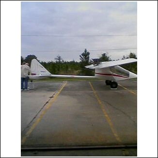

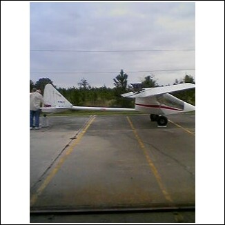

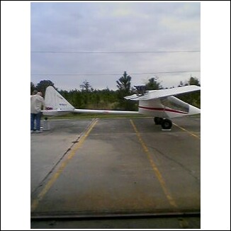

Hi guys. I am trying to do my weight and balance today for my Mark II. I don't have any information on what the level flight is. We leveled up the horizontal stabilizer. I've attached a picture.
Any information (very soon) would be appreciated.
Cristal

In a message dated 10/27/2007 11:36:14 AM Eastern Standard Time, cristalclearwaters(at)juno.com writes:
http://forums.matronics.com//files/levelflightkolbmarkii_177.jpg
it should be 9 degrees angle of wing cord on a kolb

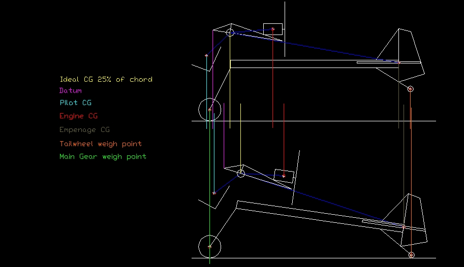

Here's an old drawing.

Here are the "old" instructions, again.

PostPosted: Tue Nov 06, 2007 2:16 am    Post subject: Re: Help with level flight attitude for Mark II Reply with quote
Of course those who have replied that the CG does not change with attitude are right ! Those who have (correctly) observed that the tail weight changes as you lift the tail are getting confused -it does not mean that the CG is moving!
The weight and balance check should be done with the lower wing surface set at 9 degrees to the horizontal. On my machine, the tailwheel is 9 inches off the ground to achieve this.
What would be MUCH MORE INTERESTING is what other MkII owners use for the position of the Pilot/passenger CG,, as it makes a big difference in the calculation. Previous owners of my plane have used a figure of 4 inches forward if datum (the front wing edge), but I reckon it is more like 2 inches. Are there any other opinions?
Interestingly, in the UK, the CG range allowed by the powers-that-be is much lower than in the Kolb manual, 16.8 to 24 inches aft of datum. When flying solo, it is necessary for even a heavyweight pilot like me to add ballast weight of 6kg in the nose ahead of the pedals.
1planeguy(at)kilocharlie.

the fuel cap.... draw a vertical line from the fuel cap to the bottom of the
wing and will intersect at 31 % of the wing cord..... all ok!!!!
2 same plane,,,, rotate the nose down till the nose cone touches the
ground:
The center of mass has not moved,,,, but if you draw a vertical line from
the center of the fuel cap to the bottom of the wing it may be at 85% of
the wing cord ok or not ok!!!!
3: pitch the nose up.... again the center of mass has not moved.... and
draw a vertical line from the fuel cap to the wing..... it may be exactly
at the leading edge... or 0% of wing cord..... again ok or not ok!!!!
Or are the examples 2 and 3 ok or not!!!! The center of mass has not
moved.... the plane would be safe.... but if the manufacture instructs
that the wing cord % cg limits should be from x to y if measured at z
angle.... then follow the instructions and you will know that it is within
limits... it is a paperwork issue....
Now if the manufacture changed the angle... he would also have to change the
limits of the % of wing cord at that angle. Rotate it too far... say 90
Deg.. and you could not get results that are helpful.
If you do the cg work according to the plans the results are predictable...
if you come up with your own angles say tail wheel on the ground,,, or
the bottom of the wing level... you will have to come up with your own
limits that are acceptable in % wing cord... and do the testing to make
sure your results are acceptable.... and it can be done... but why reinvent
the wheel.
Ok maybe that has been 3 cents worth....
Boyd
jindoguy(at)gmail.com
PostPosted: Tue Nov 06, 2007 7:36 am    Post subject: Help with level flight attitude for Mark II Reply with quote
Ray, It is said a picture is worth a thousand words. Perhaps this will help you understand why your idea that it makes no difference the position in which the airplane is weighed is mistaken.
Rather than doing trig problems as I suggested earlier, just look at what happens to the relative position of the datum between setting on the ground and level flight position.
Notice the tailwheel position changes very little.
Look at how the cg of the major components, wing, empenage, pilot, and engine, move.
Now, compare the arm from the datum to the tailwheel contact SHORTENS when you measure it. while setting on the ground. This mismeasurement of the arm is why you will get a total CG that appears to be forward of where it is actually when the airplane is in flight.
Hope this helps.
Rick

PostPosted: Tue Nov 06, 2007 8:15 am    Post subject: Re: Help with level flight attitude for Mark II Reply with quote
Cristal,
If I were in you position I believe I would:
First... I would assume that most of the Kolb flying have had their W&B done according to the manual... So, I'd do my W&B according to the photos that were kindly sent by Brother Possum. Those are photos of the pages of the construction manual, and they show how the Factory expects the W&B to be performed (9 degrees deviation of the bottom of the wing from horizontal, is the expected attitude of the plane...).
Second... To do a W&B balance by the book requires that that you have scales and other measuring devices in position... So... it wouldn't be a big deal to run a second set of measurements with the tailwheel on the ground.
Then you could inform us (your buddies on the list) if there is a significant deviation between the two methods of measurement.
Again... I would expect the factory method and expected CG numbers to be correct. I would do the W&B by the book first… use that data as a baseline, then experiment with other methods...
Good Luck...
Henry
Firefly Five-Charlie-Bravo

PostPosted: Tue Nov 06, 2007 8:21 am    Post subject: Re: Help with level flight attitude for Mark II Reply with quote
Folks, I'm going to have to concede on this whole point about the attitude not mattering.
I did the calculations and found that it is true that you CAN derive the same CG point no matter what the attitude is, BUT you have to figure out the difference in attitude between the level flight attitude and the angle you are measuring and do a bunch of extra calculations to get the answer.
Its just not worth all that extra math(and potential errors) when you can just block the plane up for level flight attitude and measure it that way and do the plain simple method of weights, arms and moments.
I do agree that simple is the BEST method of doing a weight and balance.
However, the CG does NOT change in flight unless weight is moved, say from fuel burn, a passenger leaving the aircraft, or your bowling ball rolling to the front of the plane.
You Voodoo guys can also lift the hexes and grim reaper curses as I have given in to practical conventional practice in this case.....(even though I was theoretically right Razz )
I do want to thank the contructive comments made by a bunch of you in helping me understand THE POINT of the question!
Now if only I could figure out what the "Level Flight Attitude" of my Ultrastar is....anyone???
