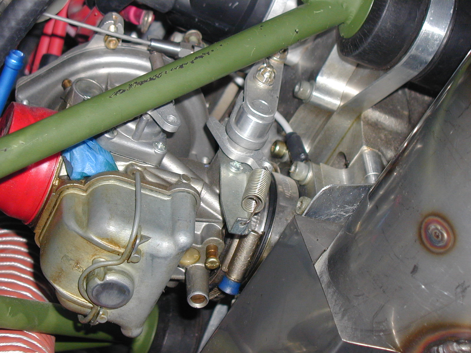

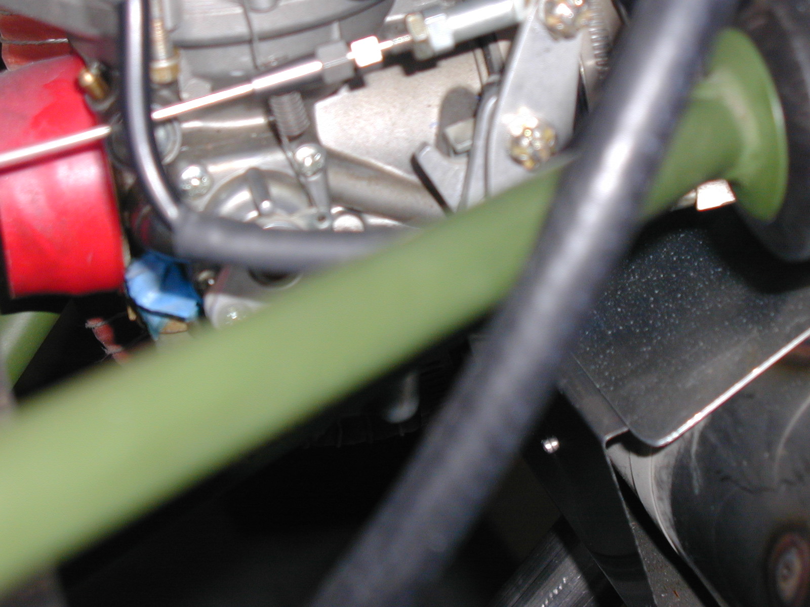

DanM
Joined: 16 Nov 2006
Posts: 64
Location: Kingsburg, Calif.
PostPosted: Wed Dec 05, 2007 6:38 am    Post subject: Re: Throttle to carb connection Reply with quote
Thanks for the information guys. Since Jay has been successful with the wire grip, I may not change mine. Lynn, how is the internally threaded rod attached to the carb lever. I can't picture it from your comments. More on my set up, I have a ACS vernier throttle which is connected to ACS wire grip in question, the wire grip is then connected to a rod end which is connected to the carb lever. I might add, the carb lever is special design and built by Dave Jalanti. His design add more throw to carb lever which gives more travel to the vernier throttle thus finer adjustments. Heres some photos of my set up.
 Filesize:  344.67 KB
 Viewed:  687 Time(s)
 Filesize:  381.72 KB
 Viewed:  640 Time(s)
Dan Mc Intyre
Kitfox IV
Jabiru 2200 SN 1311 , 59.7 hours
Sensenich 62x46
N443DM
msm_9949(at)yahoo.com

PostPosted: Wed Dec 05, 2007 8:37 am    Post subject: Throttle to carb connection Reply with quote
Dan-
I also have the Dave Jalanti-designed lever/arm. I'm going to the
hangar in about an hour and I'll shoot some pictures of mine...I
already have the cowl off. As I recall building it, the internally-
threaded rod has a head (forgot to mention that last night) and it
slides through the Jalanti arm, with the throttle wire going through
the cross hole securing the rod from going back through the arm. Then
the set screws secure the wire to the rod.
I'll get some pics.

Lynn Matteson
Posts: 2778
PostPosted: Wed Dec 05, 2007 12:15 pm    Post subject: Throttle to carb connection Reply with quote
Your installation looks very good, Dan. It sure looks more rugged
than mine. However, I've got over 400 hours on mine and it hasn't
given up yet. I tried to find that "grip" device in the Spruce
catalog, but no such luck.

From: Lynn Matteson [lynnmatt(at)jps.net]
Here's my 3rd and last attempt at posting pictures
Lynn, your photos came through but with extra files. Those extras are the resource part, including thumbnails, from your Macintosh formatting. To avoid that, select your file, press Apple+I, click the thumbnail in the Info window of the file then click Delete.
Your file icon will now be without thumbnail but the file will be smaller and more 'PC-friendly.'
