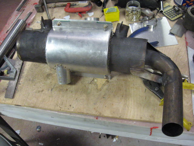

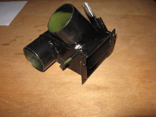

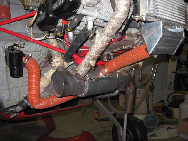

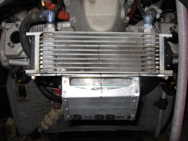

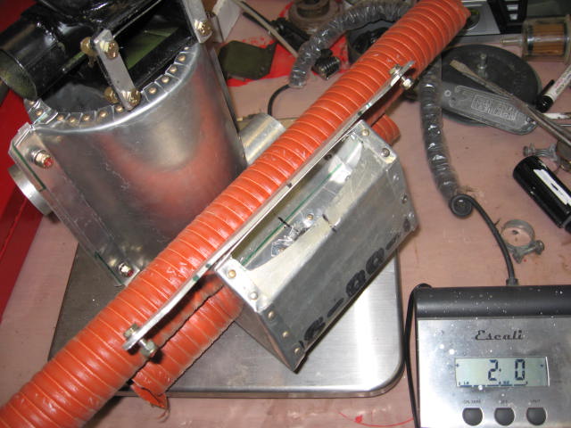

OK Gents...Just finished up a heater muff for my 912 speedster. I thought if anyone was going to undertake such a project, I might post these pics .
Total weight as shown on the scales was 2 lbs. And the Heater valve I fabricated of steel was 12 oz my itself...the single heaviest component.
All hardware is included on the scales except the scat hose clamps..which I didnt have the right sizes on hand, and the cable to operate the valve. Worked out pretty good...I just hope it heats!

Looks like a good set-up, Don. However, I'm concerned about the
exhaust pipe wrapping. In "Tony Bingelis' on Engines", he states: "I
don't recommend wrapping exhaust pipes with one of those automotive
"Exhaust Insulating Wrap" kits regardless of the claims made for
them." He goes on to cite one example of failure. I've thought about
this practice, and haven't come to any conclusion myself, but if Tony
disapproves of it, that's a pretty good sign.
Anybody else have any proof of this being a bad idea?
component.

I read something about this Lynn that stated the exhaust pipes, especially
those closest to the cylinders, need cooling. By wrapping them they keep
the heat inside, which is good for the engine compartment, but the metal
gets too hot which changes the metallurgy properties and reduces it's useful
life. This isn't my opinion, just repeating what I read and I don't know if
it is true or not. FWIW.

The Valve on the firewall is a simply flapper type air diverter valve that opens and shut via a cable on the panel. it diverts the hopefully warm air either into the cabin or out thru the round outlet pointed down to exit thru the bottom of the cowl. I fabricated this myself from mild steel sheet and brazed it together. It is kind of a copy of other aircraft diverter valves I have seen in the past.

Well, Don, if the wrapping proves to be a problem, you can also do
away with it, and just install a standoff shield on the coolant hoses
or other affected items. Of course the simplest and most direct
method is the wrap of the exhaust pipe, as you did.
Lynn, In regards to the exhaust wrap. I have Tonys Book, and I am
aware of his statement on pipe wraps. However, I also know if this
products usage in many certificated applications and how effective
it can be to reduce under cowl temps. My decision to use it on my
craft was based on the close proximity of the coolant hoses to the
exhaust pipes. The craft operated for about 100 hours without the
wrap on the pipes, and the damage to the heater hoses was begining
to show up. Also damage to the firewall blanket where the rear
exhaust pipes come very close. I considered the really good
airflow under the cowl that a round cowled KitFox has, and
determined that was was needed was something to more or less
"sheild" the hoses and blanket from the pipe, not necessarly to
reduce the under cowl temps. Hence, I opted for the wrap. Since
installing it..about 80 hours ago..I have kept a close eye on those
hoses, and am very happy with the result. Only time will tell if
there is any detri!
mental effects on the pipes due to holding in too much heat, and
if it happens, I figure that a cracked pipe is a better failure
than a busted coolent hose.
I will keep you posted on the long term effects.
Don G.

To quote Tony Bingelis a little more regarding the failure of a
wrapped exhaust system: "A local Mustang II equipped with a mild
steel exhaust system suffered complete failure of the pipes in all of
the bend areas. His thermal wrapped pipes had completely burned
through." Reference is "Tony Bingelis on Engines," pages179-182.
Just to throw in an observation of my own, I've never seen a race car
with the pipes wrapped. I've seen the ads for the wrapping, but never
seen it in use. And you'd think if any group of engine enthusiasts
would be going for that last horse, it'd be race cars. And while I'm
pretty new at this aviation thing, I haven't seen the certified
planes with wrapping on their exhausts, either....those that I've
seen anyway.
Maybe a better method of retaining heat (to raise the efficiency of
the cabin heat muff) would be ceramic coating? While Tony does not
mention ceramic coating, he does list Jet Hot Coatings in his sources.
The other thing about the wrapping is that water/ice/snow can be
trapped under the wrapping, further causing problems...I know, how
long is ice going to last at 1400°? Not long, I'm thinking: )

Roger that Mike... the valve has 2 outlets..when it is closed to the cabin, it is diverted thru the outlet pointed down. I didn't stick a short hose on it yet. Don't think it will be needed but I made it so I could just in case. It would need to be about 6 inchs long and go straight down to the under-cowl opening. I believe this will also help keep some heat away from the lower motor mount rubbers, which as you know are real close to the muffler can. I am sure your 912 speedster is just like it. my motor mount rubbers show a little heat brittle on the edges closest to the can now. This heat muff oughtta help that some.
