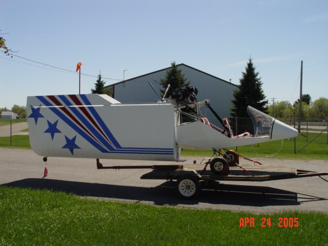

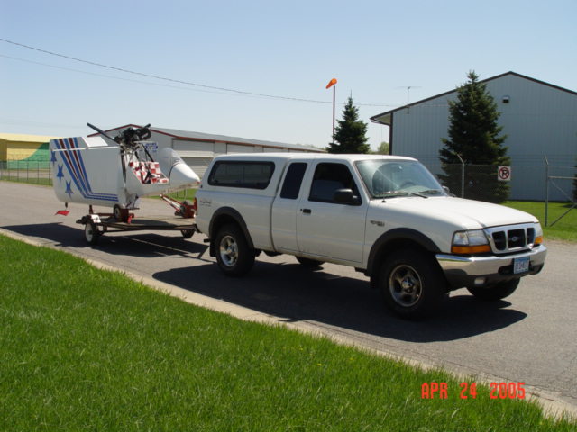

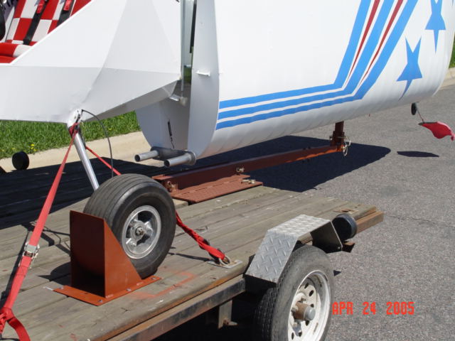

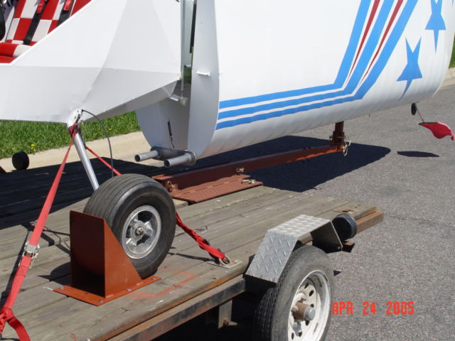

In this case.... Length " doesn't " matter...
Gotta Fly...
Mike & "Jaz" in MN

PostPosted: Sun May 11, 2008 3:07 pm    Post subject: Re: Length of the MXIII Reply with quote
Gotta Fly...
Mike & "Jaz" in MN
Tell that to your girlfriend ;^)
Seriously, how much tongue weight is on your trailer with the plane in place?
Looking at the bottom picture, it sure looks like most of the weight is way back and could make the trailer unstable, wagging at speed. How does it tow?

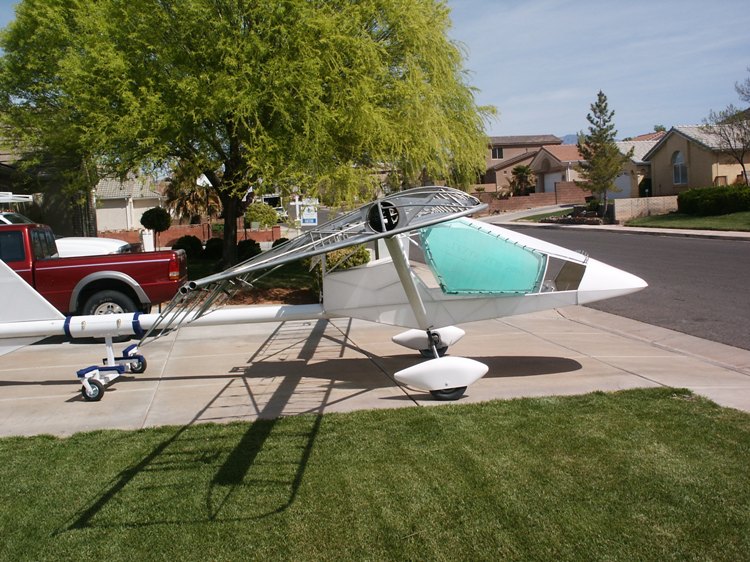

First of all, hello! I haven't heard of you before. (Maybe I wasn't paying close enough attention.) I'm glad to hear you either have or want to have an Xtra, the finest lightplane around, IMHO.
Now, to answer you question, Cloyd. An Xtra is a long SOB. I have one wing folded on my plane, so it was easy to take a reading....just hook a tape and walk toward the front. I come up with REAL close to 24' 4", or in there somewhere. In my particular case, I'll be adding about an additional 6" per wing, when I finally get my droop tips attached. So, you are looking at the minimum of about 25' interior length. Recommend 26'.
Plus, it seems like someone was asking how tall a trailer should be, to roll an Xtra inside of it. IIRC, I came up with just under 6 1/2 feet tall. I'd need 7', now that I installed the steel gear legs, which raised the fuselage by at least 5", possibly 6".
For your information, and any others that don't already know, NO, I don't have an Xtra. I have a MkIII Classic I converted to look like an Xtra. Is it the same dimensions as an Xtra? YES!!! Does it look like a genuine Xtra? YES!!! I got my dimensions from a genuine Xtra frame (Ala Pat Ladd's Xtra in Great Britain). After making all the fuselage cuts and welds, I installed a genuine Kolb nosecone. The differences between my plane and a genuine Xtra are so subtle that 95% of most Kolb owners wouldn't know it wasn't, if I didn't say anything. (Once I get it finished, I'll be raising that 95 to about 99%)

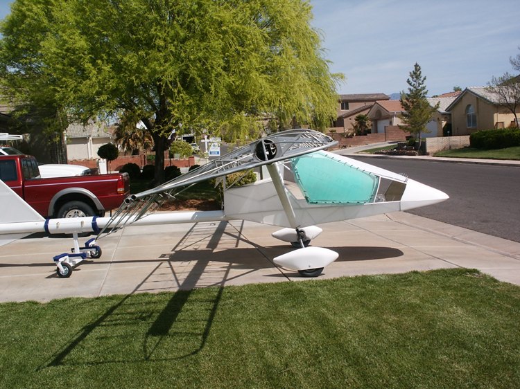

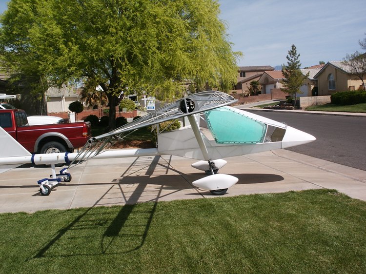

How about a few photos, if you have an Xtra already?? I enclosed a photo I took awhile back of my MkIII.
Best to ya,
Mike Welch
