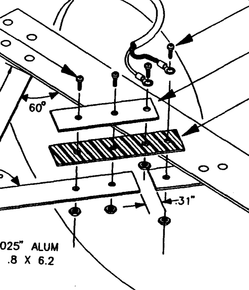

I am building a Wingtip VOR Antenna, and am in need of 1/32" thick
bakelite (3.25" x .8"). Any body have a source (mail order as reside in
Canada) for this bakelite? Thanks.

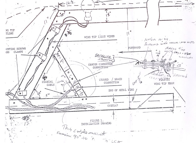

Bakelite is is the world's first synthetic plastic. It was the
material of choice for millions of molded shapes in the crafting
of consumer products back about 1933.
http://en.wikipedia.org/wiki/Bakelite
The stuff is still made but it's position in the marketplace is
more for historical authenticity or decorative purposes as opposed
to new product design. The stuff is brittle and in 1/32" thickness
would be VERY fragile. In fact, I sort of doubt that Bob's design
uses real Bakelite. I think he may have used the term to describe
the piece of plastic more as a historical recognition of its function
than for it's material. Bob is of my generation . . . many terms applied to
ideas common to our experience took on names that were more generic
than specific. I.e., all copy machines are 'xerox' machines, all
tissues are 'kleenex' etc.
The purist craftsman would recognize that this insulator
serves TWO purposes. First, it's a structural material that
maintains the position (.31" gap) between the two lower
pieces of aluminum. It's second function is to serve as
the dielectric in the capacitor formed between the lower
left and upper aluminum strips.
The exact value of that capacitor is a function of separation,
surface area and the dielectric constant of the insulating
material in the gap. This capacitor was no doubt 'tuned'
on the bench. Substitution of some plastic other than the
material used in the original design will change the value
of that capacitor.
[img]cid:.0[/img]

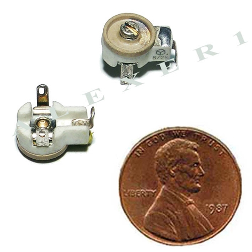

Back in my much younger days, adjustment of a
gamma match involved moving the tap in search of
the impedance Nirvana followed by a re-tuning
a variable capacitor . . .
[img]cid:.1[/img]
to wash out the new value of inductive reactance
in the gamma rod. In fact, the last antenna I built
with this technology used a capacitor very much like
this one.
In the case before us, Bob Archer has deduced the
right place to tap the antenna for 50 ohms. He also
crafted the DIMENSIONS and MATERIALS for a
capacitor that most nearly cancels out the reactance
of the gamma-rod. In the capacitor above, the
dielectric (insulator) is air. In Bob's design,
the dielectric is 'Bakelite' . . . or something
he called by name.
The short answers come with two options:
(1) use any durable dielectric material of the
same thickness to craft a similar device
knowing that the 'match' will not be optimized.
I suspect that the resulting antenna will not
suffer so badly that degradation of performance
will be observable by a pilot in the cockpit.
Epoxy/Fiberglas (like etched circuit boards)
would be good.
(2) craft a new capacitor design that is
adjustable. You could use a small variable
capacitor like this . . .
[img]cid:.2[/img]
With an adjustable capacitor, the new match can be
optimized with the application of suitable test
equipment.
Even better, I might craft a new, optimized
but fixed capacitor as a double sided etched circuit
board and even add an SMA right angle connetor
to the assembly to make a more elegant termination
of the coax.
To make a reasonable approximation of Bob's original
design, look for any plastic material of the right
thickness. 1/32 is not going to be easy, thicker
material will be much easier but demand large changes
to other dimensions.

harrismarkr(at)hotmail.co wrote:
Hi Alfio
I am planning on doing the same do you have a drawing with the required dimensions on.The drawing I have dose not have the dimensions.
Mark
Here are some dimensions (enclosed jpg), though some dimension information is still missing for the gamma match. I will probably just borrow an SWR meter and 'play'.
Thanks for all that responded. I'll be looking for paper phenolic xxx since it has low dielectric loss at high frequencies.
 Filesize:  104.93 KB
 Viewed:  21028 Time(s)
PostPosted: Tue Mar 27, 2012 6:25 am    Post subject: Source for Bakelite - 1/32" thick Reply with quote
Here's a little clearer image that I think is
adequately dimensioned.
http://www.matronics.com/forums/viewtopic.php?t=89235
Alfio
Joined: 05 May 2008
Posts: 6
PostPosted: Tue Mar 27, 2012 8:09 am    Post subject: Re: Source for Bakelite - 1/32 Reply with quote

PostPosted: Tue Mar 27, 2012 6:05 pm    Post subject: Source for Bakelite - 1/32" thick Reply with quote
At 11:09 AM 3/27/2012, you wrote:
--> AeroElectric-List message posted by: "Alfio" <longeron(at)gmail.com>
Thanks Bob. I have that one as well. I am still looking for some dimensions on the gamma match though. The gap is identified, but not how far it is from the wingtip support for instance.
Did a little autocad layout and found that the top
capacitor plate doesn't come all the way to the end
of the capacitor di-electric. Given that it's
a 60-60-60 triangle with an inside dim of 5.00
inches, the details come out something like this:
http://tinyurl.com/7jatp88
Bob . . . [quote][b]
PostPosted: Tue Mar 27, 2012 8:54 pm    Post subject: Source for Bakelite - 1/32" thick Reply with quote
Did a little Autocad layout and found that the top
Just discovered that I had the elements of the gamma-match
swapped end for end in the drawing. Here's the corrected
version.
http://tinyurl.com/7wol3jx
Alfio
Joined: 05 May 2008
Posts: 6
PostPosted: Wed Mar 28, 2012 2:04 am    Post subject: Re: Source for Bakelite - 1/32 Reply with quote
Just what I was looking for. Thanks.
Alfio

In fact, I'm considering a 'mod' to the design that
uses a variable capacitor soldered down to the ECB
material . . . which must be adjusted but it's pretty
easy to do with the ship's comm transmitter or a hand
held and an SWR meter.
