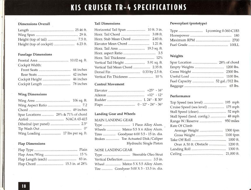

PostPosted: Mon Sep 23, 2013 1:27 am    Post subject: Re: Horizontal Tail Span Reply with quote
I have an old TR-4 specs file from Contact Magazine where the horizontal tail span is listed at 8'9". Galin's Aircraft Manual also has 8'9".
But if you take a look at the KIS TR-4 sales Brochure, the horizontal tail span is 10'3" (see attatched file). On the ZU-BKK aircrafy manual also has the same span for the horizontal tail.
That's what I though that the tail span was increased during the development of the kits.

[quote]--> KIS-List message posted by: "fasilpereira" <[url=javascript:;]fasilpereira(at)hotmail.com[/url]>

I think I can solve the airfoil thing once and for all. I fond this post in the achieve from Vance:
Date: Sep 18, 2002
From: Vance Jaqua <vjaqua>
Subject: Re: e: Aileron/flap/wingtip alignment
Both the 2plc and the cruiser use the NACA 63 sub 2 215 airfoils, with some of the cusp removed on the aft lower surface, by using flat surfaces on the flap and aileron. The 63 sets the location of the max thickness the sub 2 I think relates to the width of the drag bucket and the 2 in 2i5 establishes the design point lift coefficient and it is 15 percent thick. Use the upper surface for alignment with a template for setting incidence and normal flap and aileron positions, do not use the wing tip as a guide - split the trailing edge if you have to make it align with the settings, In general, set the ailerons at normal in the relaxed condition, and they will fly up a bit in flight for a little Wash out effect.
I really miss Vance, it was really cool hearing him spar with other engineers. I remember observing him grilling a certain young Cal Polly Tech engineer.
I can also confirm this is the airfoil for the TR-1, I plotted it earlier this year and made cradles to support the cantilever wing when I moved my TR-1C to my house. It has straight lines between 75% and 100% from the leading edge. The wing fit the cradles like a kid glove (not OJs).
The cusp was removed to make it easier to assemble the flaps and ailerons, although some builders still had trouble building this keep it simple airplane - I have two different size ailerons with two different contours and my flaps are 1/2 and inch longer in cord with a weird looking trailing edge! I guess the only way to make assembly fail safe would have been to prove builders with control surface spars and ribs!
On the subject of TR-4 elevator movement - That seems to be a development problem that never was really resolved. The metal control horn piece may have been the same one used in the TR-1. You might think that simply extending the length of the control horn would solve the underside of the horizontal stabilizer clearance issue but that might cause other clearance issues with the rudder control or bulkheads.
I forget exactly what Bob Anderson told me but he either changed the position of the idler bell crank aft of the rear seat or he may have added a second idler bell crank to change the angle of the elevator push tube. Either case at full up elevator the push tube still rubs on the bottom surface of the horizontal stabilizer, it is noticeable when you look into the fuselage opening where the elevator passes through. Attached are pictures of Bob beautiful ship.
Fabricio - I believe the airfoil for the horizontal tail is NACA 0010.
Mark T.
PS - There is no such airfoil, 65 415, in my Abbott and Van Doenhoff book!!!
