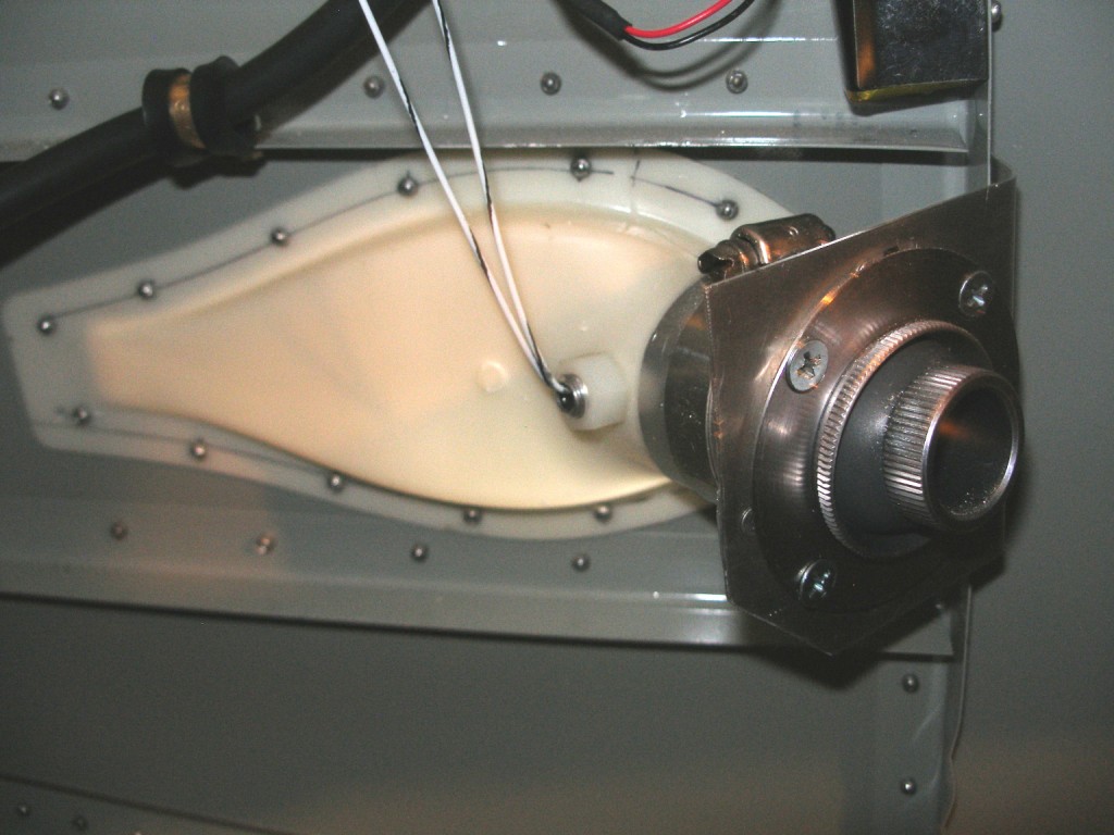

Jaybannist(at)cs.com Guest
Posted: Fri Mar 07, 2008 4:43 pm Post subject: Dynon's OAT sensor |
Hans,
I mounted mine in the right air inlet.
Jay in Dallas 601XL N2630J "Lil Bruiser"
"hansriet" <hansinla(at)mac.com> wrote:
| | - The Matronics Zenith-List Email Forum - | | | Use the List Feature Navigator to browse the many List utilities available such as the Email Subscriptions page, Archive Search & Download, 7-Day Browse, Chat, FAQ, Photoshare, and much more:
| Description: |
| Filesize: |
138.74 KB |
| Viewed: |
998 Time(s) |
| Back to top |

If I'm not mistaken, those probes were shielded so that the probe was not exposed to direct sunlight. The Dynon probe is not shielded.
Jay in Dallas

>I mounted mine in the fuselage bottom in the access hole of the co-pilot's seat just aft of the main carry thru spar. This keeps it out the sun (very important) and away from the exhaust gas. It works very good.
>Dave Nixon
