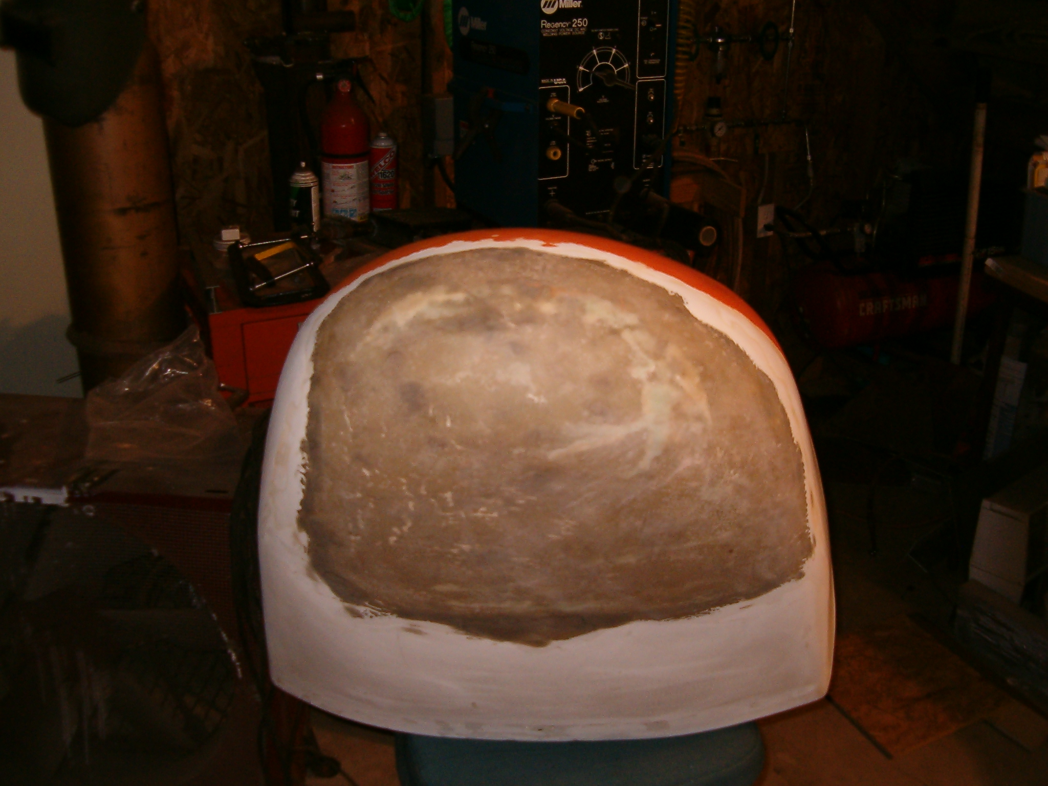

Question for the group. I cracked the gel coat and..... er.... ah.... well,
a little more on a nose up landing. It repairable but I can't tell if it's
polyester or epoxy. Any help would be appreciated. Thank you in advance!
John Murr
Original Firestar

I can help a little on this. Just went through the same thing. I had a freind who helped me. Some may know him from MV 2004 - Bruce Williams (Kitfox). He loves to play with fiberglass. He has built a couple of glass planes. He basically worked on this while I worked on some other stuff.
This is what I ordered from Aircraft Spruce. Not sure if you are talking about just a few small cracks or worse. I deformed mine to where it lost it's original shape. If your job is smaller, may not need all this. We had some material left over. It wasn't cheap and it was a lot of labor (sanding). Think I spent about $100.00 plus sandpaper. New cone was over $400.
Need to epoxy prime, sand smooth to fill and blend and if necessary prime one more time before final finish coats.
09-00100 DACRON FABRC 1.8 OZ X 64" #611 (release fabric)
4533-60 S-GLASS-STYLE 4533 5.8 OZ. 60" (Bi-directional)
01-07355 VINYL ESTER 411-350PA 1G KIT
If you need more help, Bruce would be the one to really talk to. Contact me off-list.
Check the before and after pictures to see what I was up against. Hope this was helpful. Got to remember to put thee attactments in backwards order!

John, The rule is that you can put epoxy over polyester, but not the other
way around. Prep the area with 220 grit sandpaper tapering out 2" either
side of the crack, use peel ply over the patch so it won't lift the edges
and also to save a lot of time filling the weave for finish.
